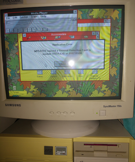

Hi, yes, I've posted it in another thread.. I think it was this one: Re: WFW 3.11 using all available ram?
I tried your variant of Quicktime, and when I open mplayer.exe now, the Video For Windows player, it always is crashing to due to general protection errors in different DLL's and EXE's. Here's an example:

Quick update for those with the EMU386 emulator running on your 286 system:
Do not run that emulator along with Video For Windows 1.0. While running it earlier, the playback FPS of my video dropped by at least two frames.
Also, I did attempt playing my video with audio on my real 286, as the audio shouldn't make a difference, but it would refuse to play. Back to the drawing board...
