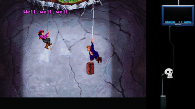

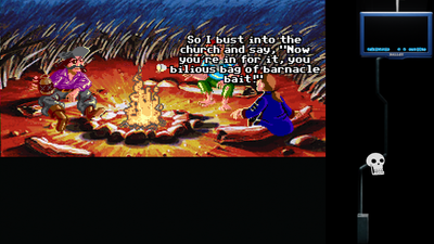

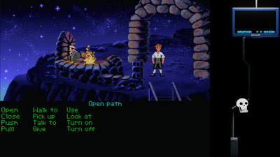

Without VGA2SCART the picture is going to be incredibly unstable because of the nature of the signal, the quality for me is excellent but i use the GBS only for the capturing part.
I added some screenshot to give you an example of the quality.

Hm, I understand. Well, the Screenshots look very good.
What about the output (from the GBS-C)? What kind of device are you using?
