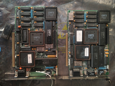

I've been investigating a pair of ancient Sigma Designs EGA cards that I got a while back from a pile of untested ISA boards.
677.48 KiB
595 views
SPEGASYNC and ERGO480
One of the cards (the SPEGASYNC) works nicely in my Turbo XT at 4.77Mhz, but utterly fails in turbo mode at 10Mhz. Both the RAM (120ns) and ROM (?) appear to be too slow. The other card (the ERGO480) fails to POST and even manages to lock the system up. But I have high hopes for it, because the RAM is faster (100ns). Thus begins the investigation...
The BIOS strings claim these are UNISYS cards. (Didn't know UNISYS made ISA graphics cards!)
The SPEGASYNC is a pretty standard early EGA card from 1986. 256KB of RAM and using the CS8240 chipset from CHIPS. Plus a Sigma Designs gate array, the L1A2334, to hold all the 'glue' logic to connect the EGA chips to the ISA bus. BIOS string says "UNISYS ENHANCED GRAPHICS CONTROLLER VERSION 1.30". It works nicely at 4.77Mhz and does all the typical EGA stuff.
On the subject of "does every EGA card have 256KB?" -- the August 1986 issue of PC Magazine, immediately after the first EGA clones came on the market, reviews 12 different EGA cards (IBM's plus 11 clones). All of the cards offer a 256KB memory option, but even more interesting is that only three of the cards (the IBM plus two clones) are available in a 64KB configuration.
But I want an EGA card that works in my Turbo XT at 10Mhz! So let's try the ERGO480.... it has two oscillators onboard, a 28.500Mhz and a 32.000Mhz; hmm, very close to 2x of the standard 14.318Mhz OSC signal and the 16.257Mhz oscillator that one expects an EGA card to use. No matter what I do, can't find the right switch settings to get this thing to POST and output a proper 15.7khz or 21.8khz sync. As a bonus, it usually also freezes the system, preventing it from even booting!
Progress is made once I pull the ROM off the card. This reveals a curious PAL16L8 hidden underneath the ROM socket, which is a bank switcher -- do an I/O write to port 03CBh and bit D0 switches between the two 16KB banks. The card maps the ROM at C000-C3FF. (Why Sigma bothered with this bank switching scheme instead of just mapping the whole 32KB to C000-C7FF is a real mystery.) I stuck the ROM into an Ethernet card's boot ROM socket and dumped the whole 32KB.
With the ERGO480 card now ROMless, I can install it alongside an MDA card and my machine is able to boot.
I can poke the standard EGA registers and bring the card up. Programming the sequencer and CRTC according to the values from IBM's EGA Technical Reference is enough to get an 80x25 text mode display up and running -- at 31.5khz hsync! Hmmm, better not plug in the CRT just yet. [If only I had an early NEC Multisync with TTL digital inputs.] The video RAM at B800 is accessible and works fine, even in 10Mhz turbo mode. I change the I/O base address jumper on the card (moving it from the standard 3C0-3CF ports to the alternate 2C0-2CF ports) so that I can both with the video BIOS ROM installed, because the ROM doesn't support (and can't detect) the card if it's at the alternate address. And I was able to confirm that the ROM is also fast enough to work reliably in turbo mode at 10Mhz.
Yes, this means it is possible to have *three* video cards installed in an XT! One MDA or CGA adapter, plus one EGA adapter at the standard 03Cx and 03Bx/03Dx ports, plus a *second* EGA adapter at the alternate 02Cx/02Bx/02Dx ports. But there's zero BIOS or DOS support for that EGA at the alternate address. Did any software or operating system ever take advantage of this ability?

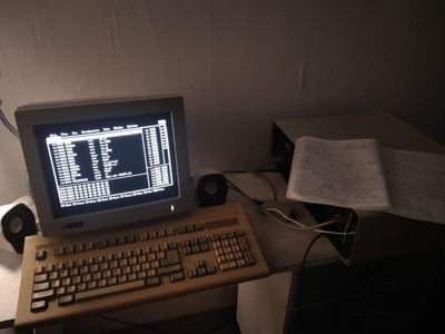

Now it's time to debug the video BIOS! I tried just jumping to the initialization code at C000:0003, but it kept getting confused into thinking it was in monochrome mode and started reprogramming the CRTC in my MDA adapter, whoops! So instead I rigged up a way to load the video BIOS dump into RAM and execute it from there. Required patching up the bank-switching trampolines to modify the CS register instead, and also had to patch up a couple of hard-coded references to the C000 segment, but... it worked! I was able to single-step through the BIOS in Turbo Debugger, skipping over any questionable bits as needed. As a bonus, TD seems to have its own MDA support that doesn't rely on any BIOS routines, and is very aggressive about reprogramming the MDA to known-good values every time it hits a breakpoint.
157.25 KiB
595 views
Video BIOS debugging session
Finally I can figure out why this card goes off the rails! And also maybe figure out what the switch settings are!
As it turns out, a couple of the DIP switches were faulty. No wonder I couldn't figure out the settings. Liberal application of IPA resolved the issue. Many of the switch settings are "standard", same as on the IBM EGA. Once I found a setting that worked (SW1..4=OFF:ON:ON:ON for colour 80-columns on a 200-line monitor) the BIOS was able to POST and write its version string to the primary display (the MDA). But then it failed its self-test, beeped out the familiar long-short-short-short code, and promptly froze the system.
By single-stepping my way through the self-test, the issue was easily identified: a bad DRAM chip on bits D0-D3 of plane #3. The memory test activates the A000 mapping for the video RAM and then tests each plane, one by one. When the test fails, it beeps out the code but then continues executing the rest of the video BIOS initialization instead of bailing out.
So it bravely carries on to the next step, which is calling its own INT 10h handler with AX=CE01h, which is some sort of proprietary Sigma extension to the standard INT 10h interface. Most likely to handle the CGA emulation. And that's what is in the second bank of the ROM: a copy of the SIGMAEGA.COM emulation utility! It even has a bunch of help text describing the various commandline options available. How weird. Anyway, the AH=CEh handler has to set up some kind of 'sane' environment before it can execute the emulation code, and it does so in the A000 segment -- which was oh-so-conveniently left enabled by the RAM self-test code.
Too bad that plane #3, which is the one left enabled, is the one with bad RAM in it. Chaos ensues and things quickly go off the rails, and the system appears to freeze because the CPU is off in never-never-land executing total garbage.
Guess it's time to order some new RAM.....

Reply 1 of 32, by Predator99
Many thanks for uploading the BIOS images first!
Thats really cool what you have done there and I also enjoy doing things like that, Turbo Debugger is also my favorite tool 😀
I also planned to try to boot a PC with MGA as primary video and a EGA/VGA without BIOS as secondary and try to initialize it with a TSR based on a BIOS dump. You have shown that its works. Very nice!
Its new to me that its possible to select the base adress of a EGA card. If you like to use 2 cards at once you also have to select another RAM segment for the 2nd one?
Dont understand however what the PAL and LS chips do..still learning 😉

When you run the BIOS code in turbo debugger, you might want to just patch the segment for the emulation data from A000 to something inside conventional memory to not depend on the broken RAM in bank 3. You can continue exploring that card in more detail until you get to install the replacement RAM that way.

Reply 6 of 32, by kdr
mkarcher wrote on 2020-10-09, 22:49:
Yep, in the end I just stubbed the INT 10h handler to ignore any calls with AH=CEh, because I'm not ready to dive deeper into the CGA emulation yet.

Reply 18 of 32, by kdr
I am intruiged by the idea of adjusting a fixed frequency monitor such that it can sync at a different frequency. It just so happens that I have a half-working fixed frequency MDA monitor -- it shows intense text just fine, but doesn't show normal text -- which could be 'sacrificed' in the name of science.
Also! Keep in mind that many monochrome monitors from the late '80s are actually multi-frequency! Even the cheap no-name generic Taiwanese junk that doesn't manage to get even one relevant Google search result!
The tell-tale sign is that the monitor has a permanently attached video cable with all 9 pins populated on the connector. I got curious one day and beeped out the pins and found that the RGB pins (3-5) were connected to something, which I did not expect. And indeed, feeding the monitor a CGA signal worked just fine, it detected the sync polarity and switched over to 15.7khz hsync like a champ. 200 glorious scanlines in 16 exciting shades of amber. This is a great CRT for testing TTL video cards [once the frequency counter has confirmed that the hsync/vsync are sane], because it's much less likely to get destroyed by a rogue video mode switch.
Reply 19 of 32, by mkarcher
kdr wrote on 2020-10-10, 01:45:
Ah yes, forgot about that one! […]
the3dfxdude wrote on 2020-10-10, 01:28:
In the IBM design, there is another register 3c5 called clocking mode register. There is a bit controlling the dot clock. So it's generated in the sequencer in the IBM design, and they should support this, if they were trying to be compatible.
Yes, the sequencer (82C432A on this card) is the chip that receives CLKIN from the clock select multiplexer. It generates CCLK for the CRTC. And actually the 'count by two' divider in the CRTC (CR17 bit D3) is actually designed for selecting between byte and word sized refresh addresses. The sequencer register SR01 (clocking mode register) bit D3 is the divide-by-2 that's used for the 40-column and 320x200 modes.
So yeah, I now have some serious doubts about register CRF9 (400 line mode) being able to generate the 14.318Mhz dot clock. Hmm. More mysteries.
I guess, I just solved a part that mystery: The card just doesn't support 200 lines modes. CRF9 is set to 3 in all 200-line modes, and set to 0 in all higher-resolution mode (including the text modes with a 8x14 character cell). This most likely means the card double-scans 200-line modes as 400-line modes (with double dot clock!), and you need a multi-sync monitor like e.g. the NEC MultiSync 2A or NEC MultiSync 3D. Did you test the theory that 200-line modes run at 15,7kHz on real hardware (in that case, my proposed solution would be wrong).
Also, the 350-line EGA text modes are not IBM compatible. The ERGO 480 runs them using a 9x14 character box instead of a 8x14 character box (just like the MDA does). You would need an 18MHz clock for that to yield EGA timings. In the EGA350 text mode tables, CLKSEL=01, which would be 32.5MHz. Also the horizontal total register is 70h, which mean 114 characters, i.e. 1026 pixels. Suppose that 32.0MHz is indeed the dot clock, that would yield 31.2kHz. The vertical total is 413 lines, which yields 75.5Hz.
It seems the available timings are:
  • double-scanned 200 line modes: CLKSEL=00, 8-pixel characters, horizontal total=70h (912 pixels), 31.25kHz; vertical total 231 (double scanned), 67Hz.
  • single-scanned 300 line 132-column text mode: CLKSEL=01, 8-pixel characters, horizontal total=0ABh (1392 pixels), 23.0kHz; vertical total 351, 65.5Hz
  • single-scanned 350 line text modes: CLKSEL=01, 9-pixel characters, horizontal total=70h (1026 pixels), 31.2kHz; vertical total 413, 75.5Hz (this includes mode 7 on non-MDA monitors)
  • single-scanned 350 line 320/640 pixel graphics modes: CLKSEL=00, 8-pixel characters, horizontal total=6E (896 pixels), 31.8kHz; vertical total 413, 77.0Hz
  • single-scanned 350 line 720 pixel graphics mode: CLKSEL=01, 8-pixel characters, horizontal total=7Dh (1016 pixels), 31.5kHz; vertical total 413, 76.2Hz
  • single-scanned 350 line 132-column text mode: CLKSEL=01, 8-pixel characters, horizontal total=98h (1232 pixels), 26.0kHz; vertical total 364, 71.4Hz
  • single-scanned 400 line mode (alternate mode 7): CLKSEL=01, 9-pixel characters, horizontal total=6Ah (972 pixels), 32.9kHz; vertical total 468, 70.3Hz
  • single-scanned 480 line mode: CLKSEL=00, 8-pixel characters, horizontal total=6Ah (972 pixels), 29.3kHz; vertical total 546, 54Hz
There is one extra parameter set at the very end of bank 2, intended for mode 8 on monochrome monitors. It uses CLKSEL=10, so no idea what frequency it runs at. It has 9-pixel characters, horizontal total=0A1h (1467 pixels), vertical total 378. The vertical timing is identical to MDA timing, so this mode is likely a left-over from a "standard" Super-EGA design that has 26.7MHz oscillator on CLKSEL=10.
None of these timings is any IBM standard timing, so your initial impression is right: This card does need a non-standard monitor, but it generates a nice 720x350 text mode at 75Hz, which really deserves the card the label "ergonomic". The timings map to the modes like this
