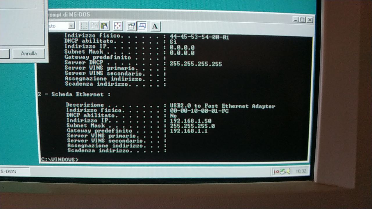

While I waited, some help. I found these drivers, specific for Win98SE, if in case they don't work, I can try the ones you recommended.
https://us.driverscollection.com/?H=AX88772&B … ndows%2098%20SE
Now the installation went smoothly. As you can see from the photo, everything is recognized without errors and conflicts.
I must point out that the first time I plugged in the LAN cable, Windows crashed, forcing me to force the PC to shut down.
Once the PC is restarted, however, it does not connect.
So I went to manually enter the TCP / IP addresses for the card.
From the image, three appear, I have configured that of the device, however windows does not connect.
I have no idea how to set up the connection correctly.
Or, even if there were no problems, the drivers are not the right ones?
I made a video:
https://youtu.be/mc20JBYY-8Y
Actually, I didn't do anything, I just installed the drivers ....
If I do ipconfig/all the DHCP server sees it disabled.
I set the IPs manually and also the Gateway
But on DNS configuration, if I enter the google DNS, then it asks me for the HOST name and DOMAIN, I have no idea what to write there.
Even on WINS configuration I don't know what to set.
I have a DES-1005D switch, the IBM is connected to port 3 and it is on, it is on steady.
LAN cable checked on Windows 10, works great.
I moved the cable to part 2, same problem, the light comes on but is fixed.
I made another video, detailed.
In the Router's Event Log, it tells me that the PC has connected. Very strange since it does not browse the Internet.
https://youtu.be/5DoA-oBsSWI
By running the command:
I get:
ping 192.168.1.1
"request expired."
Packets: Sent = 4, Received = 0, Lost, = 4 (100%, lost)
