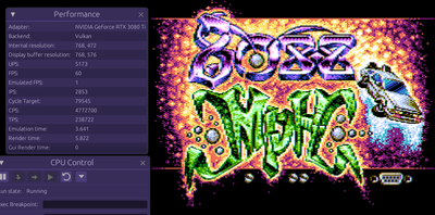

Reply 25 of 113, by GloriousCow
Scali wrote on 2023-06-02, 22:00:
I've tried it on two machines around here... one is a desktop Core i7 860 with a GeForce 970. The other is a laptop Core i7 2720QM with an nVidia NVS4200M.
But that makes me wonder: do you use the GPU for more than just trivial rendering of framebuffers generated by the emulator on the CPU?
The GPU is used for scaling the buffer to the window and compositing the GUI debug windows, but not much else at the moment. I eventually want to have a few shaders available for post-processing effects. (CRT emulation, color/geometry adjustments, etc)
So do you actually render the screen with Vulkan, if available? And if not, what does it fall back on?
I'm using wgpu to render. It will prefer Vulkan on windows/linux but Metal on Apple platforms. Here are the backends it supports: https://docs.rs/wgpu/latest/wgpu/enum.Backend.html
Also, my task manager tells me that the CPU usage is only about 25%, so apparently it's not making a lot of use of all the CPU cores available.
Perhaps some of the emulation could be made to use the extra cores? For example, the composite seems very heavy... but it's probably trivial to process it in a separate thread asynchronously, while the emulator will move on to the next frame. Which in theory would make the composite mode as fast as the RGBI mode.

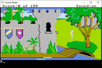

Multithreading an emulator can be tricky, but its certainly possible... Ultimately, what I planned to do is make the composite conversion into a fragment shader, which would eliminate the performance hit entirely. I have a working shader for the monochrome high resolution composite mode, but it doesn't simulate the color multiplexer yet so is no use for 8088mph:
40.87 KiB
2044 views
composite shader experiments
I'm not exaggerating though when I say that MartyPC has really no attempt whatsoever at optimization in its current form. It's hard to have the goal of making things accurate and making things fast at the same time, and I was just too excited about getting Area 5150 working to wait until I had time to take an optimization pass or two over my code before putting it out into the world. I have a fairly beefy PC (5900X, 3080ti) so it wasn't something I really had to worry about during development, apart from scenarios where I was logging incredible amounts of data. Running well on a variety of hardware is important to me, so I'll be working on making things more performant.

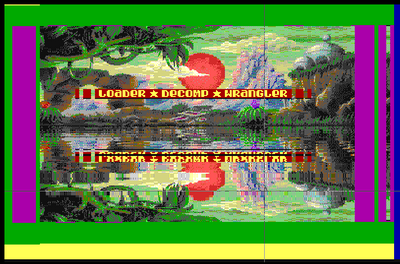

Reply 29 of 113, by GloriousCow
Ticking the emulated CGA card at 14Mhz is expensive. In the current release of MartyPC, the CGA device takes 3x the CPU time to emulate than the CPU itself.
I tried ticking the CGA by character clock, which would mean I could update the card at 1.79Mhz instead of 14Mhz. This worked for all of Area5150 except the Wibble and Lake (End credits) effects. They apparently still need cycle accurate timing.
So why not do both?
50.59 KiB
1890 views
Dynamic clocking of the CGA device in MartyPC.
If a CRTC update occurs in the middle of an LCLOCK, we switch to cycle-accurate mode until the next LCLOCK, then drop back to ticking by HCLOCK. The pink areas represent areas in the border region where the CGA card is in cycle-accurate mode. You can see several CRTC updates just before the first scanline of the effect. The vertical pink bars are then the regular CRTC updates per scanline.
This represents a significant performance boost and will be in the next release of MartyPC among with several other optimizations - Scali, I hope it will run at full speed for you after this!

Reply 36 of 113, by GloriousCow
Scali wrote on 2023-06-13, 10:00:
Yea, these improvements sound promising!
I wonder though... do you actually have a system that runs the composite emulation at the full 60 fps?
If so, what kind of specs are we looking at?
I have a Ryzen 5900X CPU, so a fairly recent and rather high-end CPU.
This is the performance view of the new build (I've added displays of the adapter and backend at your suggestion):
176.47 KiB
1730 views
MartyPC Composite performance on 5900X
This is sort of the worst-case scenario on my system as both emulation and render time have some variable spikes to them. I'd say during 8088mph emulation time ranges from 2.6-6ms and render time 4.6-6ms.
Of course as long as we complete everything in under 16ms we can run at 60fps, so in this shot I still have about 6ms of headroom. That's still a lot of resources to emulate a 40 year old computer, but consider before I made the CPU and CGA cycle-accurate my emulation time was consistently around 1.5ms, and that's prior to any optimization whatsoever.
"Emulation time" is how much time is spent ticking the cpu and all devices, including the CGA card, which does internal rendering into an indexed color framebuffer as it ticks, per cycle/pixel if necessary...
"Render time" is how much time is spent converting the index color array produced by the CGA into RGBA either via the normal means or via composite conversion, and optionally aspect-correcting it.
Composite conversion adds about 4ms of render time on my system, which is a hefty hit, true. With it off, render time is around ~0.6 ms, with the occasional 1ms spike I'm trying to track down. As a shader it would run nearly instantaneously, with the caveat that you'd be locked to a full-screen display of the window (unless I figure out how to run a shader on a subsection of the viewport)
The new version of MartyPC is at least 2x as fast, and I'd like to release it as soon as I figure out a lingering bug that rarely occurs during mode changes that throws my new character-clock synchronization out of whack (updating sync width during hsync maybe?) There's still plenty of optimizations to make, like an interpreter cache, a proper scheduler, perhaps a scheduled timer vs ticked.
