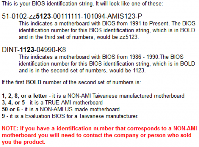

Seems AMI aren't much help
47.17 KiB
1190 views
and whoever it is, their only other board, 40-0203-428007-00101111-060692-AR810: ??? (Model 3/486 ) (Chipset: SIRUS AR-810 ISA) is also unidentified.
