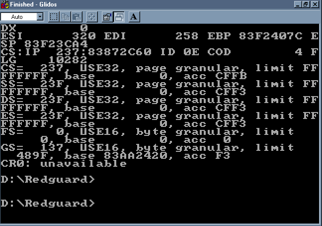

Hokay, so I tried a few more things. I removed both Redguard and Glidos, put Glidos in C:\Glidos and Redguard in D:\Redguard. I pointed Glidos at D:\Redguard\RGFX.exe so that's all good. But now, when I try to run it either in Direct3D or OpenGL, it crashes and I get this (to me at least) gobbledegook. Redguard's error log gives me nothing, I don't see an error log for Glidos, so this screenshot is the best I can currently do, unfortunately.
EDIT: And finally, I tried running Redguard and Glidos in 640x480 instead of 800x600, and got this error:
GLIDOS caused an invalid page fault in
module GLIDE2X.DLL at 0187:020fb866.
Registers:
EAX=02151d4c CS=0187 EIP=020fb866 EFLGS=00010246
EBX=00000001 SS=018f ESP=0073f9c0 EBP=0073fa50
ECX=00000000 DS=018f ESI=02b0000c FS=1a7f
EDX=00000000 ES=018f EDI=020f7c30 GS=0000
Bytes at CS:EIP:
8b 01 8b 50 20 ff e2 cc cc cc 83 ec 10 db 44 24
Stack dump:
020f91a6 00000001 00412d93 00000001 a435d1e1 01196270 01197840 00000001 0073fa44 0073fa44 00474bf8 ffffffff 0040fb49 a435d265 0073fc30 0073fc30

Reply 3 of 6, by Glidos
I haven't had a machine running Windows 98 for years, so it's been impossible to test. A few suggestions though:
Within the Adjust dialog, under the DOS tab, selection Windows for the Dos emulation, at least to get started.
If you have a copy, try getting Tomb Raider working first. More people used Glidos for that than any other game, so it's the best tested.
For installing, follow the instructions on the Glidos web site, and no others. If it doesn't work, then uninstalling and trying again, reading each detailed step is more likely to work than using someother universal installer.

Reply 6 of 6, by bc732
Ok I was having this same problem, but it was not clear that the latest version of GliDOS does not work properly with win9x. I installed 1.29, and now have graphics. There are a lot of artifacts and stuff, but at least I am making progress.
