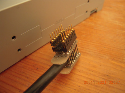

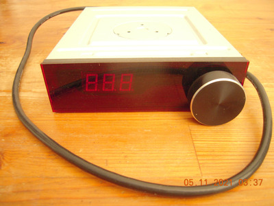

Apropos DIY...
This is a 5.25" turbo wheel with nn.n MHz display which plugs into the crystal oscillator socket.
Range is 2-33.3 MHz.
Only works with AMD processor because Intel CPUs hang when clocked below ~16MHz.

A long time ago I got caught up in the idea of somehow designing a variable deturbo that could be soldered into a motherboard. I bought a few Cypress oscillator chips that were programmable, and even found the obscure programmer on eBay at one point and bought that too. Then I started fiddling with the software, realized I didn't know what I was doing and lost interest, never touching it again.
This picture is what I thought I was trying to achieve back then, complete with the rotary dial. Looks awesome.
