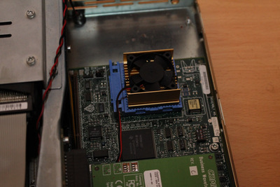

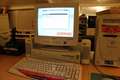

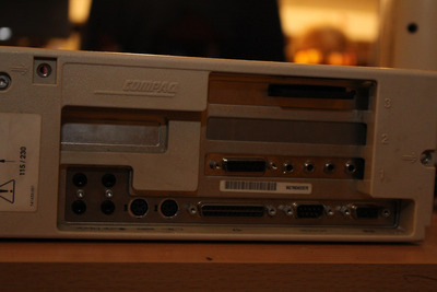

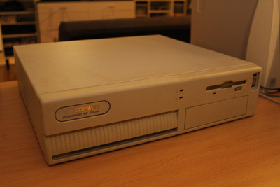

Here is one of my favourite rigs.
584.35 KiB
2406 views
600.68 KiB
2406 views

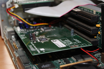

It's a Compaq Deskpro XE 433S. The previous owner bought it in 1994 and used it in an office environment for quite a few years, and didn't change anything on it, so I got it with it's original spec:
- 486 SX-33
- 8Mb Ram
- Onboard Compaq QVision 1024
- Onboard audio (I think it's WSS only)
- 3.5" Floppy Drive
- 128MB IDE HDD
- 4X ISA slots
It's since been modified with:
- 486 DX2
- Compaq Business Wavetable Sound Card (ESS ES1869F + ES692S )
- 4GB HDD
- CF Card to IDE adapter (that I use to transfer files)
- Smaller speaker (the original was very loud)
- CR2032 Coin holder (Originally it had a soldered coin battery so I modified it)
DOS compatibility seems OK, and so far I only had graphical issues with The Chaos Engine and Alien Breed (the bottom of the screen sometimes shows a black overlay).

devius wrote on 2021-11-24, 20:40:
Wow, I saw one just like that for sale a few months back, but the seller had already sold it when I contacted him. Very nice looking machine!
Thanks 😀
The one you saw is probably the one I got (I'm guessing you saw it on OLX). I've never seen one before or since.
I have a thing for OEM machines, and when I saw it, a took a chance, a long-ish drive, and after small a bargaining, brought it home.

Linarde wrote on 2021-11-24, 20:18:
This looks very, very similar to a Compaq Prolinea 4/33 I have here as my 486 machine.
But mine doesn't have an integrated Sound chip, and had that ***** of varta barrel battery, which, corroded part of the mainboard, which I repaired myself.
Mine came with a 486DX33 in it, and a different Video chipset, which is an ET6000, willing to upgrade for a DX2/66

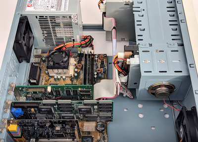

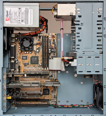

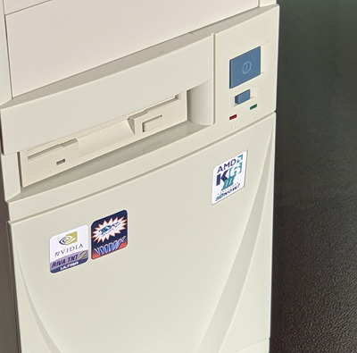

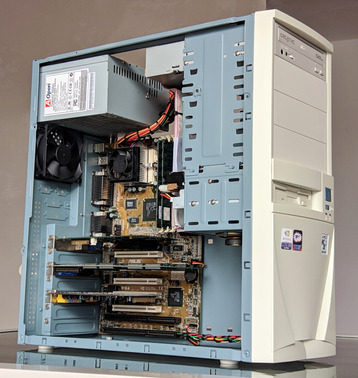

Released in late February 1999 with general availability in late March 1999, the Super socket 7 AMD K6-III CPU was the last iteration of the NexGen Nx686 architecture implemented by AMD after the aquisition of the company.
Sporting full speed OnDie 256Kb L2 cache, this CPU had a faster Integer unit than the P6 Katmai. The FPU wasn´t bad either, but no match for the IPC of the Katmai. Basically the 4th iteration of the architecture, it supports enhanced 3DNow! and MMX instructions.
This K6-III 400 running at 450MHz (4.5 x 100MHz), operates on the good/fast ALi V chipset equiped with 512Kb of 100MHz SRAM. This efectively gives the CPU 3 levels of cache, called by AMD, Tri-Level. 128MB of PC100 @CL2-2-2-6 are installed.
After lots of tweaking the AGP is perfectly stable with the TNT2 Ultra. The choice of the card was purely contemporary and the possibility to have stellar 32bit at 1024x768 resolution. 800x600 Glide is garanted by the good 1998 Voodoo 2 12MB. The sound card doesn´t need introduction.

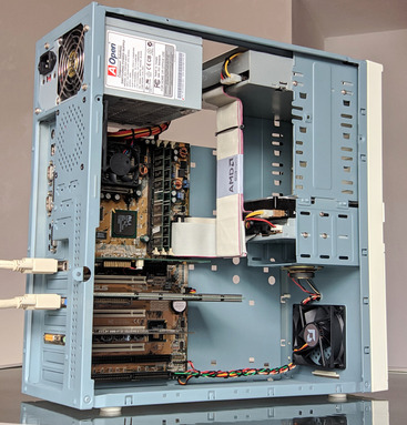

More pics
