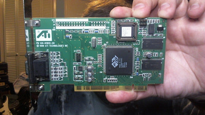

So I JUST caught this error after a few years.
In my 1997 Socket 7 built, I'm using a PCI card marked as the ATI Rage 2C. The card markings are as follows:
On the PCB itself:
ATI (logo)
PN 109-61800-00
©1999 ATI Technologies Inc
On the BIOS chip: RAGE2C PCI 61801.100 (on a sticker on top of the chip in the socket)
On the actual graphics chip:
ATI 3D (logo)
Rage IIc PCI
215R2PZUA21
B8S75
9942AA
Taiwan
But when I start the computer, the first VGA BIOS message I get says this:
ATI MACH64 BIOS P/N 113-61801-100
And within Windows 95, it has the following
Device Manager lists it as: ATI-264VT3 (English) (DirectX)
Advanced Display Properties:
Manufacturer: ATI Tech. - Enhanced
Chip type: Mach64GT
DAC type: Internal
Features: DirectDraw(tm)
Software version: 5.21-C9N-WEB
If it was just Windows saying it, I'd say I installed the wrong damned driver. Problem is, it's saying the same thing on first BOOT, so maybe someone flashed the wrong BIOS onto this card? If so, how do I correct? Help!
Reply 1 of 8, by FFXIhealer
Nevermind... I think. I just found THIS PAGE: http://www.dosdays.co.uk/topics/Manufacturers/ati.php That says:
"The mach64GT (commonly known as the 3D RAGE) introduced hardware support for 3D operations. The 3D RAGE included all mach64VT features with the addition of hardware 3D acceleration, improved video filtering, and integrated motion compensation (RAGE PRO only)."
So I guess this is normal behavior. I mean, the card works. I guess I'll just live with it unless I can figure out something else.

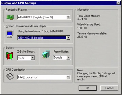

Reply 4 of 8, by FFXIhealer
OK, after a hard restart (the few times I like having a reset button on the case), I got 3DMax99 up. It's reporting the following for the ATI card
Total Video Memory: 4074 KB
Texture Memory Available: 2538 KB
Running the tests at 640x480, 16-bit color, 16-bit Z-Buffer Depth, and Double Frame Buffer for an apples-to-apples comparison between the ATI Rage IIc 4MB card and the Diamond Monster 3D Voodoo 4MB card right next to it. I fully expect the Voodoo card to do WAY better.
Running the ATI benchmark now - can we say glitchfest?
    60.63 KiB
    825 views
    ATI Rage IIc Benchmark Setup Window

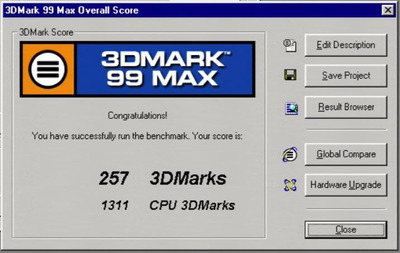

Reply 5 of 8, by FFXIhealer
Ok, so the results for the ATI card are in.
Unfortunately, I cannot successfully test the Voodoo card right now because I keep getting this error:
3DMark could not initialize your 3D Accelerator.
Try to downgrade your display settings.
DirectX Error Message:
DirectDrawSurface4->Blt : DDERR_NOBLTHW
This error happens when trying to start the 2nd game demo. It runs the first game demo fine and is a lot smother than the ATI card.
    43.88 KiB
    816 views
    47.65 KiB
    816 views
    Final 3DMark score
