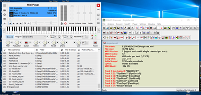

Reply 128 of 151, by Falcosoft
mateusz.viste wrote on 2022-01-10, 21:25:
K.A.R.R. wrote on 2022-01-10, 20:16:
u can easily hear and see the difference with gus1.wav and dosmid1.wav file with audacity best is to import them and play both a […]
with audacity
best is to import them and play both at the same time.
song 2 and 3 seems to run at the same speed
i included them to compare
Thanks for the clarifications, I was focusing on the wrong files. Looking carefully at the gus1 vs. dosmid1 versions it does seem like DOSMid plays the file slightly slower. I compared the length of the original MIDI file as reported by another player, and it comes up about 2s shorter than what DOSMid computes, which would translate roughly to 0.9% difference. I am amazed that you were able to spot such difference at all. I am not sure of the source of this inaccuracy, but it's most probably a rounding error in timing calculations. It does not seem to be a regression, since v0.9.5 computes the same time, so it's a little inaccuracy that is probably present in all DOSMid versions. I will definitely look into this.
Hm. I could not reproduce the slowdown problem with version 0.9.6 and using MPU output. Dosmid detected the length of Angieshe.mid as 3:31 ( it seems gus1.wav and dosmid1.wav are the recordings of this file).
It is very close to the real length of the file that is 3:31.31.

Reply 129 of 151, by mateusz.viste
Falcosoft wrote on 2022-01-10, 21:47:
Angieshe.mid is indeed the file to look at, and yes - DOSMid reports its length as 3:31. What I did is that I loaded it in a Linux MIDI player (audacious with a MIDI plugin) and I noticed that it reported the file as being 3:29, so I assumed (naively, perhaps?) that the Linux player computes the proper length.
How did you obtain the 3:31:31 length exactly?
http://mateusz.viste.fr | gopher://gopher.viste.fr

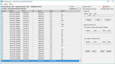

Reply 130 of 151, by Falcosoft
mateusz.viste wrote on 2022-01-10, 21:59:
I checked it with my Midi player that is very precise in this respect (and has no such reported issue with a rather large user base). I have also tested with GNMIDI that is also a trustful program:

So it seems to me that the really audible slowdown in dosmid1.wav is not because of miscalculated song length.
@Edit:
There are legitimate events at time 3:31.31 (position: 213001; beat 111-04-361) but some players tries to be smart by skipping some events from calculations (End of Track, All Sounds Off etc.) to prevent long running empty/silent parts.
The above or simply badly written calculations can explain the difference. I do not want to be over confident but I'm 99% sure that my calculation is correct.
