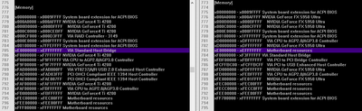

TL;DR - you might be running into an issue similar to the one I had with the MSI K8T NEO-V motherboard: MSI K8T NEO-V + Athlon 64 - very slow 3D performance in Windows 98 (works great in Windows XP)
For some reason, that motherboard has an AGP related bug that causes it to run at a third its normal speed in Windows 98 (and, boy, I sure tried all possible driver and BIOS versions!).
However, it works perfectly in Windows XP. And it's not something related to the chipset, I know for a fact that the VIA K8T800 is very fast in Windows 98, since I have other boards with the same chipset that don't exhibit this problem.

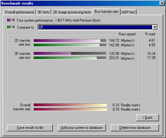

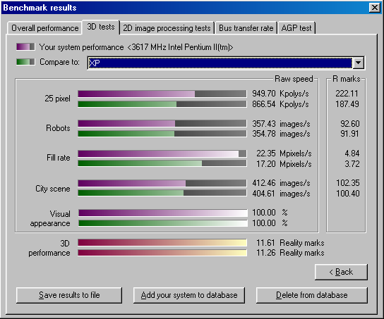

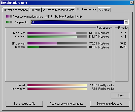

The plot thickens with this graphics performance issue. I ran Final Reality on 98SE and XP with driver version 61.76 (98) and 61.77 (XP) to see what exactly is causing this slowdown.

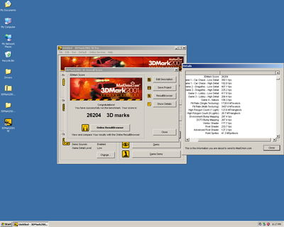

But first I ran 3DMark01 again to see how 61.xx performs, 17,183 for 98 and 26,533 for XP. Almost a 10,000 point gap.
Final Reality benchmark
17.31 KiB
3288 views
8.46 KiB
3288 views
8.25 KiB
3288 views
10.34 KiB
3288 views

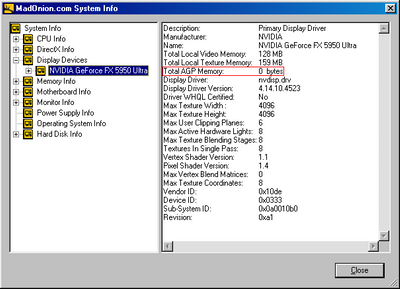

AGP bandwidth doesn't seem to be the culprit. 3D transfer rate seems almost half of what it is in XP, could that be the smoking gun?
But it gets more complicated. I also ran ArchMark 0.50 for a more broken down benchmark.

Bit of a text vomit from my spreadsheet but the values I'm interested in are:
Left is 98, right is XP:
Bandwidth:Draw	28608.411 M B/s	28727.120 M B/s
Bandwidth:BurnedByRAMDAC 238.291 M B/s 190.641 M B/s
Bandwidth:Physical 28846.701 M B/s 28917.761 M B/s

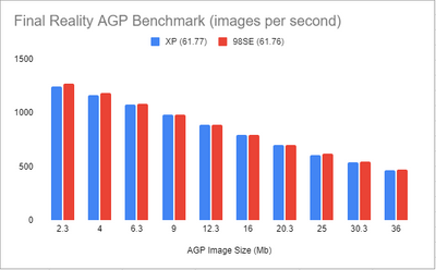

It seems 98 is equal in this benchmark, which is OpenGL based. Could it be API specific? The "Readback: Small" stats are even weirder as 98 is much faster there. Even stranger is that ArchMark is reporting that the GPU is in PCI mode, even though I'm clearly getting AGP bandwidth, and both Nvidia CP and Powerstrip report I'm in AGP mode. Maybe it's related though?
But before I aligned the drivers to 61.xx, I ran Final Reality on 98 with 53.04 drivers and got this for my bus benchmark (XP was running the MS included 56.xx driver):
What?
8.5 KiB
3288 views
Maybe the newer driver isn't optimized for that particular benchmark? Was it misreported? I'm still at a loss here. I'm trying to find a benchmark that has an OpenGL and DirectX mode to compare. I'm trying to benchmark Half Life, since that has an OpenGL and Direct3D mode, but now it's bluescreening on launch in 98.
Reply 25 of 106, by TrashPanda
Its very likely that the Hybrid AGP port on this board and others like it is the culprit in Win98, its not 100% AGP but rather AGP emulated via PCIe.
I have a very similar board and it too has odd results under 98, took me a while to find out that the AGP slot isnt true AGP, it explained all the odd issues and results. I eventually just installed XP on that system as it has full PCIe support and handles the fake AGP port better.

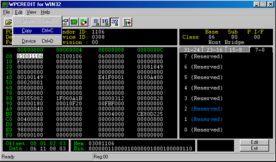

So where does that leave this? Well I want Vogon's help. I want to see what a working AGP aperture looks like on Windows 98. From the registries in the Host Bridge, PCI-PCI Bridge, and GPU, the memory resources allocated to each device by Windows, and what is polled by 3DMark01. By default, Windows 98 creates a resource conflict with the Host Bridge and the PCI-PCI Bridge. I didn't pay it much attention since just manually setting it seemed to fix it, but now I am very suspect of it. If you'd like to help please PM me or post here.
I used WPCREDIT to look at the registers, pictured is a fast way to copy it to text.
14.03 KiB
2974 views

Small update:

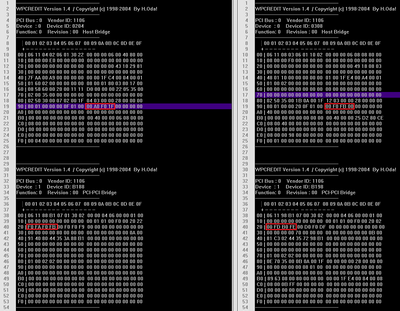

With the help of Joseph_Joestar, I've been comparing a working GART configuration on their K8V-MX with mine.
One thing that stood out to me was the xE0000000 - xEFFFFFFF allocated to Motherboard resources when it seems it should be given to the VIA Standard Host Bridge. That Host Bridge is the device that configures and exposes the AGP and GART. I tried forcing the VIA driver on that device but it did not make a difference. Considering that on a clean install of 98 this device throws a memory resource conflict, I think this is the trouble maker. I'm just not sure how.
Memory allocations. Left: Joseph_Joestar/Right: Mine
25.35 KiB
2704 views
I've also been trying to make heads and tails of the memory pointers in the registers but I'm not a computer scientist. Relevant ones are in red. The top two are listed as the "VIA Standard Host Bridge" in Windows and control AGP and GART. In red is the Base GART Low Address. The bottom 2 are PCI/PCI bridges that show up as "VIA CPU to AGP2.0/AGP3.0 Controller" in Windows (confused yet?). They don't expose any AGP configuration but the registers in red are also partially responsible for mapping the GART. I think... I hope that someone who really knows what they're looking at can help out. I've searched Google far and wide for this problem and while many report it, no solutions are provided.
Device registers. Left: Joseph_Joestar/Right: Mine
30.91 KiB
2704 views
