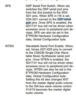

My final few hints in this thread:
  • Make sure you have the WTEN and SDD bits set in the hardware configuration section of the EEPROM. Do this carefully if your card has an on-board CD-ROM controller, as there could be problems.
  • Test with the SPS bit also set. Note that noise may be introduced via the digital input, depending on the design of the card, and what UNISOUND does with the mixer registers.
I've tried a few flashes of the 24LC16 with INIs from the Orpheus versions, after I tried just renaming the card in my own INI to Orpheus. In both ways the card then gets detected as 'Orpheus' and the /XOFi /XOFe flags indeed start working.
Setting the /XOFi, the part plays nicely from the internal FM. Switching to /XOFe, though, it starts squeeking and squealing while playing any- and everything.
So, I went back to my working configuration (with no IFM set) and also no SPS, WTEN and SDD. In this, the part plays perfectly fine from the external FM, though of course no switching to the internal FM is possible (via unisound) - reflashing the eeprom with an IFM bit set, it plays nicely from the internal FM. Therefore, electrically, it seems to all work nicely - at least in these isolated settings.

SPS is generally required for Orpheus, and since we're "tricking" UNISOUND into thinking that it is working with an Orpheus card, this would be perfectly reasonable behaviour. Orpheus was designed with that in mind, and does not use those pins for data transfer to peripheral devices.

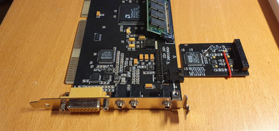

To avoid polluting the UNISOUND thread, I didn't ask the crucial questions, but will do so now:
  1. Are you connecting the external synth via a DAC, or trying to use the wavetable serial port to make a digital connection?
  2. Can you post clean photos of the card, showing your modifications?
If nothing else has worked so far, I should be able to put together a quick, stupid utility to select the synth, based on your answers. Since you are using UNISOUND, I assume your WSS base I/O address and control base address are 534H/120H?
It is worth noting, however, that you cannot have both a digital connection via the wavetable serial port and use XD0-7 for data transfer. If you're not, then we should be in business.

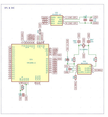

Reply 3 of 34, by MJay99
640K!enough wrote on 2022-03-29, 03:15:
The first point seems to be exactly where our mental images of the implementations are incongruent (therefore making the Orpheus' way fail on my card):
I just added the YMF289 via a DAC (using all the datalines) where as Orpheus seems to be using the pins in their other (WTEN, SPS, SDD) configuration option. I actually based that on an example of the 4232's datasheet:
102.06 KiB
1544 views
My way wasn't too much driven by the concept, but more an iterative approach: I had first added a wavetable header, from which I'm coming with an analogue audio back to the CS4237. Then I decided to try and add the OPL also, so I attached it to the XD0:7 pins and taking the DAC-approach to mix its analogue out with the wavetable signal, in order to feed that into the Line-In of the CS.
This is also why I'm almost expecting it would start working if the /XOFi and /XOFe flags were available for the generic CS4237 init of unisound.

[*]Can you post clean photos of the card, showing your modifications?
I'll attach a picture of the card a little later, but it's probably not gonna help showing much - it's a black PCB, and all the traces are impossible to see (it's also become an insanely populated area). The schematic would probably help to show more:
109.79 KiB
1544 views

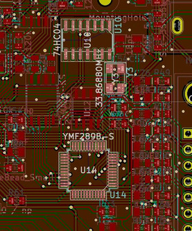

Reply 5 of 34, by Marmes
I would do this :
74HCU04
It would help you I think.
On your SCH I would remove C74.
    91.87 KiB
    1508 views

Marmes, thank you for your help, too! May I ask if the 7404 is more intended to delay or reshape the MCLK - or has there been any other intention that I am not seeing right now (e.g. some 3 to 5V level shifting)? I'll definitely keep it in mind, in case I'm starting to think the DAC is failing. Right now, my theory is that initializing the part with WTEN, SPS and SDD is making the YMF go nuts on the data, since it seems to be working fine when I init it with my INI (without those flags) instead of the Orpheus one (which introduces them) and it also fails when I a) remove those flags, but b) use unisound on a fake orpheus name in my config.
So far, the card actually seems to be working nicely with the external OPL if I don't try to force unisound on it, in order to easily switch between the internal and external FM (which is something I would very much like though, as it's my default tool for an init and would add a fun feature to this thing). That's actually what I tried to gain by asking JazeFox if he could maybe implement it. 😀
Btw. the C74 is just an option - I added it to being able to test routing of the ISA's 14,318 to the oscillator IC and maybe being able to remove the extra generation of that CLK at the MK1420s. As for it not just being a 0 Ohm jumper (which it actually was when I sent the card out for production): I did read somewhere that when using the ISA-bus's CLK, it should be isolated by such a cap - which is why I repurposed it in the schematic from an R to C. It still hasn't even been used or tested at all - so far, the MK1420 is getting its clock from the crystal (which do have 0 Ohms, so I can disconnect them for testing the other option).

Marmes wrote on 2022-03-29, 18:10:
I've now tested that clock being provided from the ISA-bus (still coupled in via the C74 cap) and it seems to work fine.

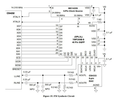

As for removing the MK1420 completely: where do you source the 33Mhz from that it provides to the YMF289? I'm guessing it's a dedicated crystal there, then?
So far, I've had no issues sourcing them through e.g. Aliexpress, but I see your point in better not using them for a new design.
Though, I have to admit, that's something I didn't bother with too much till now, as I wasn't really planning anything (commercial) with it.

Reply 15 of 34, by Tiido
It should be 33.868800Mhz (44100 * 768) goes to YMF289, and MCLK output of the DAC (which is half, exactly what Crystal needs) goes into Crystal, and problem is solved.

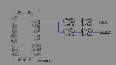

Reply 17 of 34, by MJay99
Tiido wrote on 2022-04-04, 18:14:
Hi Tiido, that is actually what I also understood from Marmes' hint - I was really just hoping there might have been an unknown way to maybe not needing the 33.86880MHz crystal.
It really wasn't much of a problem, more a bit of a moot point to me personally, if I'm adding a crystal and 7404 in order to remove the MK1402 (which I was able to easily and cheaply source from China) - even more since it had to be done in the most crowded area of the board. If I could have done it without adding the crystal, I would have instantly been sold on it 😁
Still, of course, I now had to try if routing it was possible - and it was:
115.62 KiB
1149 views
So, cheers to both of you! 😁
Reply 18 of 34, by Tiido
What is the inverter for ? If it is for making an oscillator you need to bear in mind that almost all crystals bigger than 25MHz are 3rd overtone and you need an additional inductor+capacitor to supress fundamental mode oscillation.
YMF289 already has 3rd overtone oscillator in it so the crystal sould directly connect to it and 16MHz output from YMF is enough to drive the one chip (the Crystal).
Reply 19 of 34, by MJay99
Tiido wrote on 2022-04-04, 21:41:
The YMF would be driving the Crystal and the DAC here - I really just took Marmes' recommendation from above, expecting it to be more than well tested in this configuration already (and even more for him being one of the brains behind a well-known CS-based card).
