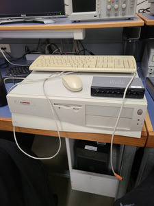

It looks like I'll wait for a GeForce MX for now, but I will add I have this nice Compaq that is a P1/MMX with a S3 Virge that just needs a hard drive and BIOS floppies (which the floppy drive on the P3 is acting weird, so I haven't been able to deal with that yet) that should be able to deal with games like Wasteland and earlier DOS games.
About 4 years ago I was also gifted a P2 from my High School teacher, but I hadn't touched it as it needed a PSU, RAM, and Hard Drive. Thanks to my college I've now gotten those parts (minus the HDD) so I could dig it out and mess with that too, tinkering with the hardware is fun 😀
