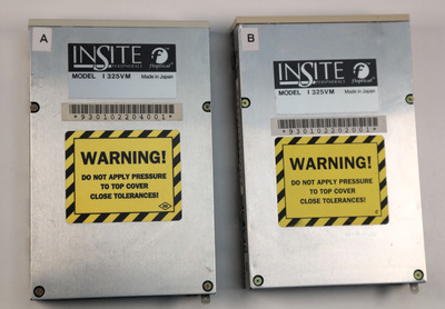

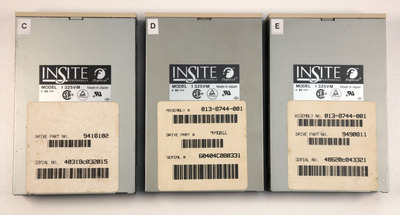

Here, you can see two very distinct types of I325VM Flopticals:
Here is a shot of my Flopticals from "PC" platforms:
843.09 KiB
2432 views
...and those from "SGI" Platforms
948.1 KiB
2432 views

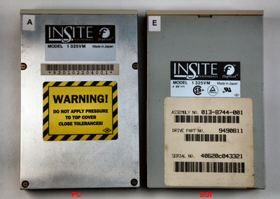

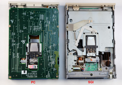

Comparing the differences between PC and SGI Flopticals (Both are "Insite I325VM"):
Top:
1.04 MiB
2421 views

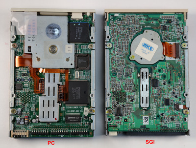

Bottom:
1.56 MiB
2421 views

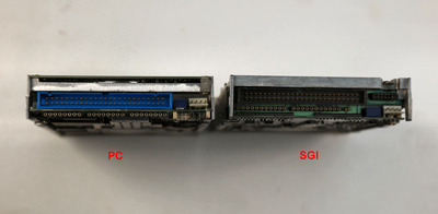

Rear (Note that the PC Version uses three 8 pin terminators and the SG version uses two 11 pin terminators):

...and here are the drives with the covers removed:
1.04 MiB
2421 views

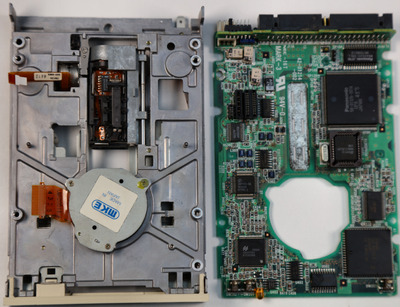

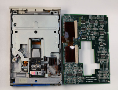

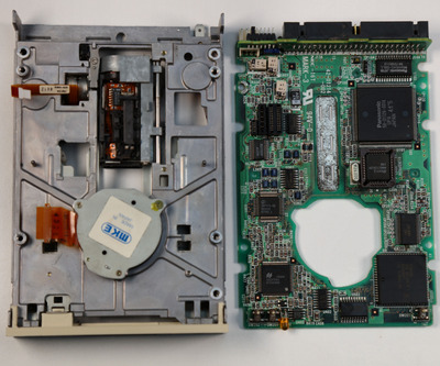

The PC Drives have TWO PCBs (Top/Bottom) while the SGI Versions only have ONE (Bottom). Here are some more photos of an SGI style drive which I have partially disassembled:
Photo with the Bottom SGI PCB removed (focus favoring the PCB):
1.06 MiB
2411 views
Photo with the Bottom SGI PCB removed (focus favoring the Drive). Note the large laser assembly:
1.14 MiB
2411 views

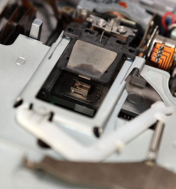

Here is a relatively decent photo of the lower head on an "SGI" drive (from the top of the drive). (SGI and PC heads seem to be relatively similar). Note the TWO heads on either side of where the laser passes (I assume). This is why you don't want to use a floppy cleaning disk as these narrow heads will catch the fibers. Looks like two heads on top and two heads on the bottom with a laser shooting between them for alignment:
272.29 KiB
2411 views

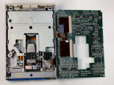

Photo of a PC Drive with the top PCB removed (focus favoring the PCB):
1.18 MiB
2411 views
1.17 MiB
2411 views

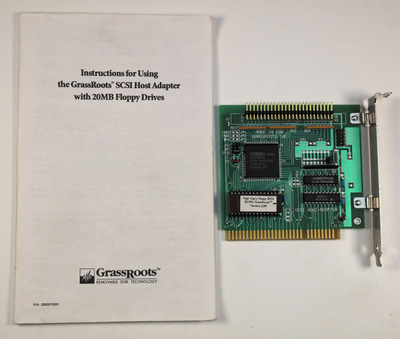

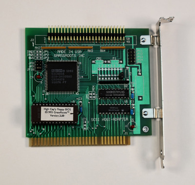

GrassRoots Floptical Controller and Manual:
840.87 KiB
2409 views
GrassRoots Floptical Controller:
610.73 KiB
2409 views

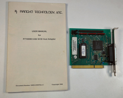

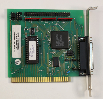

Rancho (Sysgen/ValueStor) Floptical Controller and Manual:
625.36 KiB
2409 views
Rancho (Sysgen/ValueStor) Floptical Controller:
617.29 KiB
2409 views

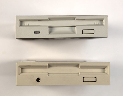

...and a shot comparing the 3D Printed faceplate I designed (Posted on ThingaVerse) for the SGI Drives (With PC original for comparison) :
532.56 KiB
2408 views

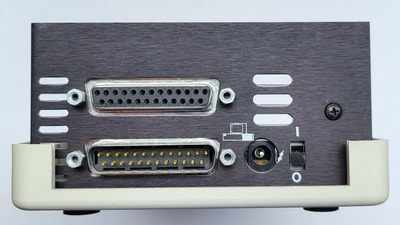

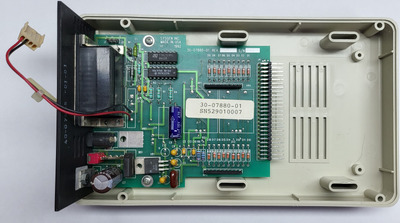

Here are some photos of the hardware in the Atari Falcon "Freedom Floptical" enclosure I recently acquired. Someone had bastardized the enclosure along the way to completely sidestep the internal electronics and just ran a flat SCSI cable out of the box instead. It appears that this board is just likely some sort of generic SCSI converter (DB25 - HD50), but but as the PCB is from Sysgen (a Floptical distributor), I figured it might be worth a couple of photos for the archive.. When I got this, the only connections to the PCB were for power and SCSI ID (which was SOLDERED). (Somehow the eBay seller never mentioned the device was modified in any way and curiously avoided any photos which might show the "new" cable protruding from the case...)
769.64 KiB
2324 views
