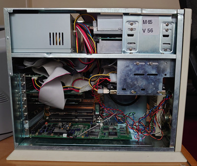

Hello All
I have finally finished with this build as I started it back in 2020 (First Lockdown) and been tinkering, trying different parts, different configurations etc and after a long while of doing it on and off, I am happy enough with it and think it best it can be with hardware and era that I am aiming for 😀

Motherboard - Abit AB-PB4 Rev 1.3
PSU - 200w
Processor - Intel DX4 100 (SK051)
Ram - 32mb (EDO)
Graphic card - Diamond Muitmedia Stealth64 DRAM (2mb)
Sound Card - SoundBlaster 16 CT2830 (with Dreamblaster X2GS)
Network - Intel Pro/100+ PCI
SCSI - Adaptec AHA-1520B Adaptec AHA-2920C
Drives
- 5.25 Floppy (360k - 1.2mb)
- 3.5 Floppy (720kb - 1.44mb)
- Seagate Medalist ST3660A - 545mb
- CF Card Adapter - 4gb
- Nakamichi MJ-5.16 5-disk CD-ROM (SCSI)
- Iomega zip 250 SCSI (External)
I/O Ports
- 2x DB-9 M Serial
- 1x DB-25 F Parallel
- 1x AT Keyboard Port
- 50 Pin External SCSI Connector
- Gameport/MIDI Port (On Soundblaster Card)
- 1x Ethernet Port (On Intel Netwrok Card)
Extras
- PS/2 Keyboard (AT to PS/2 Adapter)
- Serial Mouse
- Gravis Gamepad
Operating Systems
-MS DOS 6.22
-Windows For Workgroups 3.11

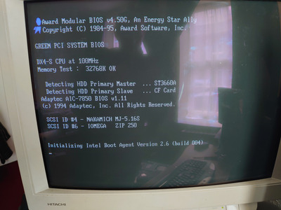

SCSI is bit different though, plus the CF AND spinning rust IDE.
What/why you got on all 3?
thank you, i am aware how standard it is and common the parts are but it works well and it not too overkill
the case i got from a friend where it was his old pc and he was gonna throw it out and i grabbed off him but had not use the original mobo as it has a barrel battery and it leaked.
scsi is use for the 5-cd changer cd rom drive as its one where is faster (16x) than original 2x speed cd-rom and also where other ide drives (4x - 8x) didn't really work well and thought scsi would open up something different for future ideas
the spinning ide drive came with pc case and still works well and also like the sounds when it reading and writing - more of a nostalgia sense and if it works no issues, why get rid of it till it does die
the cf card for games/ storage and easy transfer from modern pc to this pc etc etc
