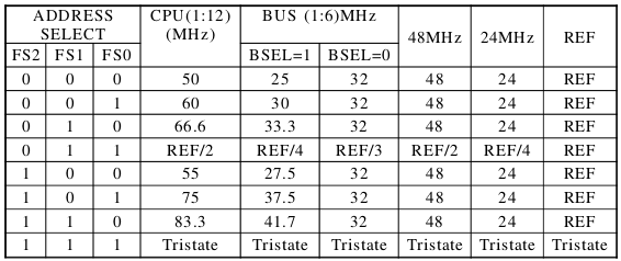

Reply 26 of 40, by carlostex
Sphere478 wrote on 2022-05-23, 06:32:
I believe that making it external would possibly have to tap and sever all the bus lines, translate it to a higher clock somehow, then attach to the cpu.
My hipothetical idea is to divide the clock just before it touches the CPU. Dividing the 50MHz bus, let's say by 2, before the CPU and send it to the CLK pin while using a 2x multiplier would yield a 50MHz CPU speed. This would effectively "trick" the CPU into believing the FSB is 25MHz when it is not. The benefits are obvious: you only slow down code execution by halving the clock speed and keep bus access effectively the same. This leads to excellent system responsiveness while only slowing the code execution.
I think it would be a better approach to look into clock gens that support 7mhz fsb
By my own experience i have to strongly disagree. I have a DFI 586 ITOX motherboard using a ICS9169 PLL with the ability to clock at 7Mhz. The experience sucks completely. The code execution of the CPU is fine at 14Mhz, its as fast as a low clocked 486 but the I/O and the system responsiveness gives an experience far slower than an IBM PCjr. A cold boot is excrutiatingly slow, imagine Pentium boot code having to run with such crippled I/O and memory access.
Also look above: So BUS clock is 7,159MHz and PCI clock is divided by 4! So instead of a 25Mhz PCI bus clock when selecting a 50MHz FSB you get 3,57MHz for the PCI clk. That's astonishing slow and not helpful at all. Plus USB ports will stop working and everything on the Super I/O that requires the 24MHz clock to work will stop working, including the keyboard. To try out this setting, i had to sever the CLK trace going to super I/O and then mod a 24MHz TTL oscillatopr and patch into it. Only then i could do anything useful. Still, the system is just not useful that way, Disk I/O, Memory I/O and Video are extremely slow rendering the system a complete useless thing. Its fun to try it once, but not useful at all.
I'm not saying that what i'm suggesting is easy in any way, and i understand its completely out of scope for this project but it's just an idea. Thoretically a Pentium or Pentium MMX at 50MHz would be as fast as a 486DX-100WB, but disabling branch prediction, V pipe and MB cache could bring it down quite a bit into mid 486 levels.
Is the CLK input on the CPU just a TTL signal? If it is i wonder if i could feed the a CPU clock directly.
Reply 27 of 40, by Sphere478
carlostex wrote on 2022-05-24, 01:59:
My hipothetical idea is to divide the clock just before it touches the CPU. Dividing the 50MHz bus, let's say by 2, before the C […]
Do you have a schematic and a IC in mind?
If so we could maybe do a collaborative effort.
But I think if the bus and clock are out of sync that it would cause a error would it not?
If you are right though and you just have to change the clock pin…. Omg.. woupdn’t that just be amazing because that also opens up higher clocks also.
In any case, I think if you feel that there is something to this that we should make a new thread.
I’ll make it if I am to do the pcb part of it so I can keep OP updated with progress. But let me know your thoughts.
Edit: Socket 5/7/SS7 (clock signal interposer) Tweaker (Research)
