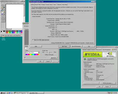

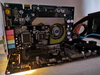

So, I got yesterday a Ryzen 2700 CPU and some MSI board on my hands (B350M-PRO VDH) and I tried to install Windows 98SE . For a PCI-E only motherboard, it worked out pretty well:
CPU, motherboard & RAM - no problems (you have to add PCI-E bus manually once Windows 98SE installation is done)
SSD 480GB on AHCI mode - no problems
Compact USB keyboard - some problems (being compact uses Fn for PrintScreen and some other keys, emulation doesn't like this, otherwise OK, including gaming)
PS/2 mouse - OK, unless I use Fn on keyboard
nVidia 7600GT - it works! With default Directx 6.1 couldn't start Quake II, but affer upgrading to 9.0C all good
PCI-E CMI8738 - it works fine, no stutter in games (there are tons of these to buy brand new)
Theoretically, on board Gigabit Realtek LAN should work using DOS drivers. Did this on some other motherboards.
If I hook-up a PCI-E to USB with VIA6212 chip I get a fully functional Windows 98SE on a PCI-E only motherboard.

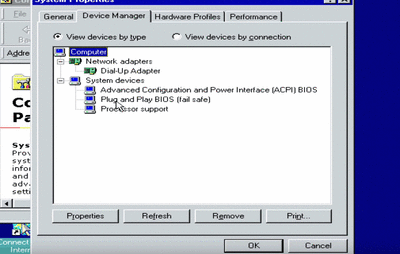

On a typical Windows 98SE installation, you might get a blue screen when detecting hardware, but this is not the end... After restart, installation will continue and you'll get to desktop. In this scenario there are no unknown devices in the control panel, just some basic standard devices like "Plug and play BIOS".
106.96 KiB
1117 views
To install PCI-E or PCI hardware you need to add the PCI bus using "Add new hardware" option in the control panel. At this point Windows will get crazy... it will take about 5-10 minutes to close 30-40 dialog boxes: "Next -> Next -> Finish" for basic hardware like "PCI to PCI bridge"or you can already provide drivers for sound, video, USB cards. (if you have any)

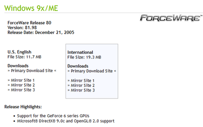

Driver version is 82.69, these are some "modded" drivers. (only .inf is modified) - https://retrosystemsrevival.blogspot.com/2019 … ivers-8269.html
You have to consider that only GeForce 6xxx series are officially supported.
Some EA games might give a CPU error but CPU speed it's not a problem in general. Pentium 4 (Northwood) reached 3.06 Ghz in 2002 when Windows 95 😳 was the most popular OS - https://www.cnet.com/culture/windows-95-remai … erating-system/ Using a Ryzen 2700 @ 3.2Ghz base speed won't confuse Windows 98...
There is a working patch for 2GB or more, but I prefer not to use it.
