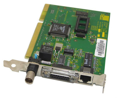

I have a 486 running MS-DOS currently, with a 3com Etherlink III NIC. I believe I can simply hook this into my router and it should work (provided I have TCP/IP drivers? not sure about this entirely), but I am wondering if there is something I can do to make this wireless? Like, can I get a network extender/small router and plug into that, which is part of my network? I have some idea of how this could work but I am wondering if anyone else has done something like this already.

Wireless range extender is not a bad option.
I use the ISA 3c509b etherlink III 10-base-t network cards in my old computers.
And it worked fine with the TP-link wireless extender.

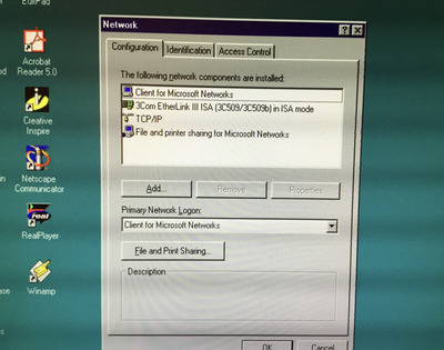

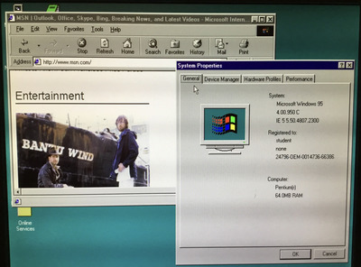

Reply 12 of 19, by Intel486dx33
I hooked up my old computer with 3com network card and Yes it works with the Linksys RE9000. It Works great with the 3com ( 10-base-T ) 3c509b network card.
I am pleasantly surprised. I was not sure if this Linksys would support 10-base-T networking cards but it does.
I am using a Win95 computer with 233mhz Pentium CPU.
I have Network neighborhood and internet working over the Wifi extender.
Don’t know what the download speeds are but must be the MAX supported by the 3com 3c509b.
The negotiated connection speed is 10mb per second. ( 10-base-T ).
Works great and internet is snappy and quick.
I can access my home WD MyCloud NAS just fine too.
Works Great…..

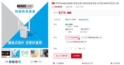

Reply 15 of 19, by dormcat
I use a TOTOLINK EX200 for all my retro computers across the room. The single LAN socket doesn't bother me as only the WinXP build requires constant Internet connection; older builds either have their on-board NIC disabled from BIOS (enabled only when needed temporarily) or no connectivity at all, as I rarely turn them on at the same time (don't have enough monitors 😅).

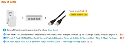

Reply 19 of 19, by dormcat
Intel486dx33 wrote on 2022-06-27, 11:52:
I would recommend the TP-Link Wireless N extender for a computer slower than a Pentium.
US$34 for just an 802.11N extender? That's awfully expensive. TOTOLINK EX200 cost me less than US$10.
140.53 KiB
1011 views
Equivalent to US$9.39 today.
