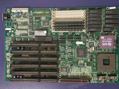

I finally managed to obtain such a motherboard, so I could try my luck at a 486DLC + VLB build.
It's a UTD 4700 ALL IN ONE, made by Up-To-Date Technologies (never heard of them): https://stason.org/TULARC/pc/motherboards/C/C … ALL-IN-ONE.html
It came with a 486DX2-66, which booted flawlessly. However, as soon as I installed a 486DLC and switched it into 386 mode, that's where the problems began.
First, it would get stuck on the "WAIT" boot screen. I had to disable "auto WS and bus clock set" and add a cache wait state.
It was still not stable enough to fully boot from floppy, so I had to disable the Fast Gate A20 Option (not sure what this does).
After that, I was able to install Windows 95, and run games + benchmarks. However, I ran into more issues when trying to install NT 4.0 (as a stability test). It would be unable to copy files at random, and always lock up before completing the last graphical phase. It was not truly stable.
A memtest revealed countless errors within seconds (should've done this first, guess my excitement got the better of me). I tried tweaking several more BIOS/jumper settings, swapping stuff out, but the only way I could get the errors to go away was to switch back into 486 mode. Then even a DX2-66 @ 80 gives no errors.
Here's what I tried to no avail...

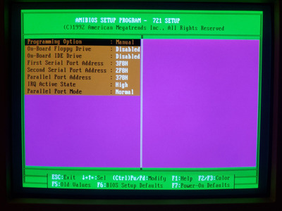

-ISA Multi I/O card, disabling on-board IDE and floppy

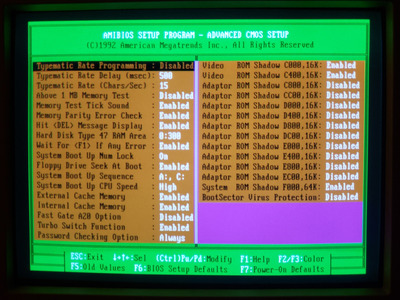

BIOS settings:
-System Boot Up CPU Speed high/low
-External Cache enable/disable
-Internal Cache enable/disable
-Fast Gate A20 Option enable/disable

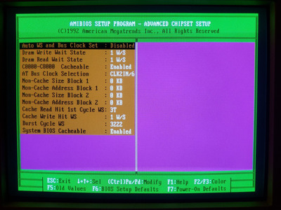

-auto WS and bus clock set disable
-Dram Read/Write Wait State, AT Bus Clock Selection, Cache Read/Write Hit WS, Burst Cycle WS— safest timings and basically all combinations

In conclusion, the motherboard works great when I plug in a 486, but as soon as I switch it over to 386 mode, it becomes unstable. Did I miss any BIOS or jumper settings that might make a difference? Maybe a cap went bad? Any input would be greatly appreciated.

AT bus clock CLK2IN/6 is too fast I believe. CLK2 would be 66 or 80 MHz for a 33 or 66 MHz 386, so 11 or 13 1/3 MHz. You want CLK2IN/8 or CLK2IN/10 if you have those...
A 486 doesn't use the double-speed clock which might make a difference...
Reply 8 of 19, by NScaleTransitModels
CLK2IN/8 is the lowest it goes. I tried CLK2IN/4 and /8, but it makes no difference. With either setting I can boot to Win95 and the sound card works (but memtest fails), so maybe they meant CLKIN instead of CLK2IN.
I tried both 128K and 256K jumpers, and enabling/disabling the cache in BIOS. Still failing memtest.
One option I haven't tried is Non-Cache Size Block and Non-Cache Address Block 1 and 2. The settings are 64kb, 128kb... up to 8192kb. Anyone know what this does?

NScaleTransitModels wrote on 2022-06-29, 17:45:
I just won one of these on an auction, and it has some battery damage and a missing chip on the top left of your image, near the ex-battery location and KB connector. Could you do me a favor and take a more detailed pic of that area so I can read the chip and look at the traces? Much thanks!
