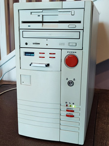

I recapped the motherboard with Kemet polymer capacitors, well the 10µF caps are polymers but there were two 1µF capacitors (on some earlier post I wrote one 1µF but there were two) and there was also one 4.7µF capacitor between ISA slots. For the 1µF and 4.7µF I just used electrolytics that I happened to have. I wanted to replace the tantalums before they explode and polymers are supposed to be best alternatives for tantalums. I also replaced the single 330µF electrolytic capacitor this motherboard has. Well, everything works but they didn't all fit nicely. I intentionally bend the 1µF capacitor on the left side of heatsink. Even the original tantalum was placed so that it blocked the heat sink clip on the socket. Now it is not a problem anymore. The other 1µF on the right side of the socket is bend a little because it didn't fit otherwise.
I did more retrobright stuff. Here is front of the case and here are the failures closer. And I should have removed the Pinus logo.
I did try to remove the Pinus logo. But it didn't come loose and I didn't want to use force. I thought it was plastic so I just taped it so it wouldn't get affected. But no, it was not plastic. Looks to be copper covered with something shiny. Brass perhaps? Well it did start to corrode. I'm glad I had tape over it. Otherwise it would be too far gone. Now I was able to clean it with IPA and try to fix it with gold marker. But it was too dry so I'll have to get another one.
But the other mistakes. The orange buttons now need to be repainted. And I didn't even like the orange originally but now I think they should be restored. Next the disk drive. It is now too white and the color is uneven. I suppose it is better than badly yellowed ones but... I don't know why it got that bad. I did check it many times and it looked like it is not good enough. Even when I washed it it looked good, actually. But after I left it to dry, this was the result.
And same almost happened to the case front bezel. If you look carefully, there are couple of small white dots there. And one small piece over the 5,25" drive bays is completely white like the disk drive. That small piece was the most yellow to begin with and it became white a lot sooner than the rest of the case was ready. Picture lies a bit. It may look like that it should be little more white but that is not the case. When compared to the painted metal parts of the case, this front bezel is a little bit too white now. But only a very little so it does not matter. I was very lucky with this one. A little more and it might have looked like the disk drive. I'll paint that small white part. I'll need to get paint anyway since I'm going to make new 1.8"HDD-CF-adapter that also includes McCake display and buttons. And since I now need to repaint buttons as well, those McCake buttons are going to match the colors of other buttons.

Here are more pictures of the new McCake drive and new HDD-CF-drive. The 1.8" HDD to IDE adapter I now used is better than the old one (I think those are in the Copam thread). The previous adapters have issue with HDD led. It only works when CF card is connected (slave drive). These new adapters are much easier to mount and the improved design is easier to assemble.
I'm quite happy with painting as well. It is not quite correct color but it is actually very close to the painted metal parts of the case. I even considered repainting the case. I bought furniture paint with color code RAL 1013 (oyster white). That was not correct with anything. It was too white. So I made my own mix with whatever leftover paints I had. Color is quite good now but I don't know the color code.
Orange buttons are repainted with gray primer and orange spray paints. The orange color is more red than original but I like this one better. I used the same paint for McCake buttons and I wanted them to look a bit like the reset and turbo buttons. Buttons could have been thicker. I used ice scream sticks as buttons but I should have glued two sticks together. But these work and look nice so no worry. There are some minor glue residues on the display and the display would have been nicer if it would be red or orange. But I'm quite happy with end result.
I did need to remove 3.5" and 5.25" disk drives and replace them with combo drive. 8x Mitsumi CD-ROM-drive is now in use. It is quiet but could be even more quiet so I think 4x or 6x drive would be even better.

Here are some new pictures now that the system is complete (for now).
Cards from top to bottom:
Roland MPU-401AT + McCake
Lo-tech ISA CompactFlash Adapter (for XTIDE Universal BIOS that can be reflashed. 3COM NIC could also hold the ROM but not flash it)
* VLB multi-I/O card with Vision QD6580 IDE controller
* VLB #9 GXE 64 with S3 Vision864
Roland SCC-1A
3Com Etherlink III 3C509B
GUS Extreme
* means original card for this system.
Notice the Corsair 650W ATX PSU. It has been modified to AT PSU with -5V. I used it when I did all the benchmarking previously and it works just fine. I did have to make a bit hole to the case under the 120mm PSU fan.
But what CPU is there now? I decided to go with WB Intel DX4 and it is clocked to 100 MHz so no overclocking. Why this? First I don't want to overclock. Sure, this CPU would be quite fast at 120 MHz but this already runs everything 486 needs to so no need for the extra speed. And I don't like the idea of 40 MHz VLB even thought there were no issues at all with it. Also, since this computer has always used DX4-100 (Intel WT) I didn't really like the idea to use Cyrix (but I was tempted). And the Intel WB is the only CPU that had only pros and no cons compared to the original CPU. This is a bit faster and never slower, slightly lesser power consumption and no need to disable both turbo and L1 cache for cycles. Disabling L1 alone is enough (for Yamaha OPL3. Now that I have ESFM, nothing needs to be done or games that otherwise need slowdown, deturbo 1/3 alone should be enough).
Why is there SCC-1A? Well, no good reason. McCake can do the GM/GS stuff as well and SCC-1A is set to port 332h and IRQ3 to prevent conflicts. Most likely I will later move the SCC-1A to another system. It's been many weeks since I've last coded MIDIto and I don't know when I'll have time to do so. But next version should have option to relocate MIDI IRQ so I will be testing that with the SCC-1A.
Speaking of conflicts, there was a MPU-401 conflict with GUS Extreme.
