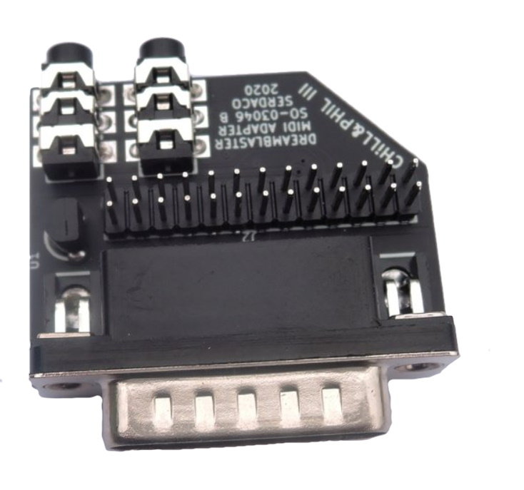

Hi iam using this through my gameport on a SB16 CT CT2770 which has no Wavetable port. I dont get any sound out? Tried the E-Wave and the XM2GS.
The Adapter has a 12vdc included so it should even work on original older wavetable boards...but no sound! Gameport is working as i can get my mt32 pi working on
it without any problem. i tried SoftMPU but no luck either. Any clues?

Which version of the Chill & Phil is it? If it's the IV a bit of a no-brainer, but are you sure you're hooking audio up to the line-out, not line-in?

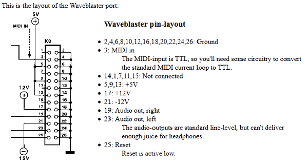

Otherwise, break out the multimeter and check voltage pins on the header. 5, 9 and 13 should be giving +5VDC. If they don't nothing will work. 17 should do +12VDC, 19 -12VDC. The E-Wave shouldn't need them, but worth checking anyway.

I see, well mistunderstanding! Sorry. So how do i meassure and what exactly? The Wavetableheader on t he Chill and Phil from Up, left to right?
That should fit right?
waveblaster_pin_layout.png?type=w2
And its this one just with the 12v added
And yes ive going output to sb16 input..Input is on and recives sound from the mt32 pi as example.

5,9,13 = 1,9v
17+21 = 9,25v
took another multimeter
5,9,13 = 2,13 v
17+21 = 11,02v
Funny so it seems gameport gives out right voltage and the Adapter somehow halfs it...hmm i dont get the problem to be honest.
Could it be a that 12 and 15 give out only 3v? The Jumper is set to Medi and Joystick=? Maybe One or the Other? Cause as far i know Joystick are 3V right?
Reply 8 of 12, by dionb
If the 5V line is only giving 2V, that explains why you're not getting any sound...
12 and 15 are suspicious though - on a legacy joystick-only port, they are GND and +5V, but on a dual-use port like this they are MIDI IN and OUT. In MIDI mode there shouldn't be any voltage on them unless MIDI is actively being transmitted. If there's +3V on both it sounds like something's wrong - but then the MT32Pi wouldn't work either.

Well found the problem, 4 and 8, 4 and 9 only give out 2.13V on Gameport. And the Adapter only uses 4 and not 5 as Ground so i need a workaround...Still no clue why the Soundcard does this. Its a CT 2770 Value.
Couldnt i well solder 4 and 5 together? As both are Ground? it should work? Maybe a fuse between for safety?
Reply 10 of 12, by mkarcher
Peter.Mengel wrote on 2022-07-20, 22:22:
The sound card should connect both 4 and 5 to ground. If they are not both ground, the design or your product is broken. So adding a connection (for example by soldering) is the correct fix.
Reply 11 of 12, by dreamblaster
Yes it is not problem to connect pin 4 and 5, that should help
