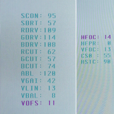

Reply 27 of 37, by vorob
The attachment 2682F806-6CBB-4442-952D-94EF12D1FC1A.JPG is no longer available
Guys, i've got some news! I found service menu. No idea if these values are from factory or previous ovener, but green driver is definetly overdone. I've made RDRV and BDRV to 100 and GDRV to 80. Now i've got proper colours and default RGB menu can be used for tempereture setting, not the colour fix.

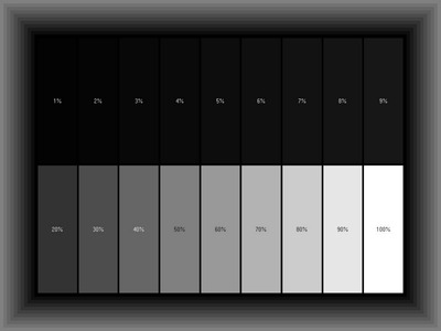

Reply 30 of 37, by vorob
You are talking about this image?
The attachment f83d7060dcdb8882_zoom.jpg is no longer available
I can see all segments separately, so no clipping in shadows and bright areas.
I wonder what are the default values and what other menus do, maybe i need to alter there smth... 😀
How do you access the service menu? I have the exact same monitor, and it would be interesting to have a go.
Reply 32 of 37, by vorob
Press and keep pressing select and then press power button for some time. Screen will blink and now when you open degauss menu it will open service menu instead.

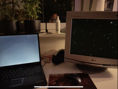

Guys, can you please clarify one thing for me. If I open a complete black image on crt, should properly set up monitor emit light of not? The reason I’m asking is because I can’t understand what I should strive for.
As I said before, I can see all bars in contrast test from Nokia.
Reply 36 of 37, by mkarcher
vorob wrote on 2022-08-05, 19:54:
If you open a completely black image, the monitor should not emit any light (or at least be very close to it).
Reply 37 of 37, by pentiumspeed
Correct, any scanlines not visible too where any black areas.
This will be little tougher with aged CRT. Worn cathode surfaces emits less, forcing one to adjust higher to compensate, at the point you can't have black anymore and then the appearance of image look poor.
This is why I do not like Sony (All!) and any monitors and TV that based on automatic kine adjustment. Cannot be shut off and is major cause of killing CRT rapidly, no matter what.
Cheers,
