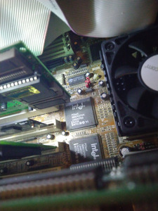

Reply 1 of 13, by asdf53
The voltage regulators are easy to spot, they are close to the CPU socket and look like this: https://en.wikipedia.org/wiki/TO-220 or this: https://en.wikipedia.org/wiki/TO-263
You can touch their metal tab to see how hot they're getting. Depending on the type, you can also screw a metal heatsink on them through the hole.
For discovering undocumented FSB settings, locate the clock generator chip (it's near the FSB jumpers) and google the model number to see if there's a data sheet. This would then contain the pins that you need to set.
But no idea about discovering undocumented vcore settings.

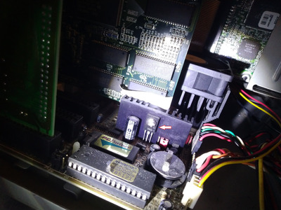

The one marked with the arrow? D-882Y? Then it should have already an heatsink attached to it... too bad as you can see that there is the voodoo 2 basically touching it preventing some airflow to come from CPU heatsink(with some isolating tape i put there on a second thought(that pci slot is the only slot where i can insert the card).
So i guess installing the AMD k6-2 and enabling 400 mhz frequency @ 2.5v the result will likely be:
1) the tape would probably melt
2) the VRM would explode/fail/melt
3) some heat will go to the voodoo 2 probably damaging that too
oh i get the situation now.
I will try to stress test the Pentium 200 mmx and report back the maximum temperature the VRM heatsink will reach on the worst situation...

Reply 3 of 13, by asdf53
That's a very big heatsink, I wouldn't worry too much. You also have that big CPU cooler near it. Just let it run with the K6-2 and keep your finger on the heatsink, it's only a problem if it gets so hot that you can barely touch it. Also remember that most boards have two or more of these.
I have a Socket 7 board that has two regulators with no heatsink at all. These get insanely hot, so hot that the metal tab on one of them turned brown over time, and the PCB around them gets to 85 degrees celsius.

Glad to hear that thanks! i see there is only one attached to the heatsink but right next to the regulator on the pcb there is another set of three pins. that is probably an unused slot for another regulator maybe??
That being said, it's a shame there is that Voodoo 2 so close to the regulator heatsink i will try to get a better solution for it. My concern anyway was if the regulator was rated for only 5A or something like that and will wear faster than normal...

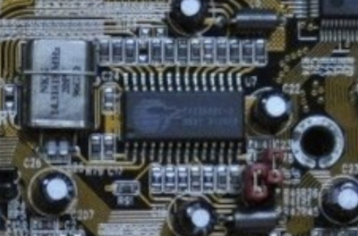

Higher fsb: we need a close up pic of your clock gen. So we can look up the datasheet.

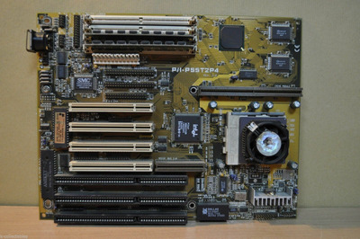

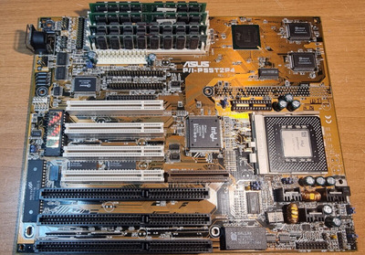

The Asus P55T2P4 had a version with single voltage, and one with split voltage. You can see the difference in the size of the heatsink on the VRM of the two different versions and the addition of copper chokes on the split voltage Rev. 3.1.
Dunno where is the clockgen. Can you kindly help me locate it on the same picture you posted before?
Okay, if there are two regulators and you have the jumpers for the voltages then it is probably a dual plane board.
This is the clock gen

Anyway the clockgen is on this photo here. it's a CY2260SC-3 9641 313100
    1.34 MiB
    531 views

50-66mhz seems like
