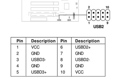

I recently got a Msi K7t Pro and the USB header has 10 pins. As far as I knew they were keyed with 9, and originally had 8 but added the 9th so they could key the connection. Anyone run into this? Thank you for your time
Reply 1 of 11, by Repo Man11
The nine pin layout is nice because standards are nice, but early USB implementation (especially with AT motherboards) was all over the place. I've a PCChips M520 that has a ten pin USB header and in that case the pins are the same as the nine pin. But there are also some motherboards out there like this illustration. If there is any doubt, you are best off to verify the +5 volt pins with a volt meter. The first time I connected a USB dongle to an AT motherboard back in 2001, I was saved by my power supply as it sensed the ground fault and wouldn't power up because I had a ground pin connected to a +5 volt pin.

I didn't easily find the manual for the K7T Pro, but I did find one for the Pro 2. It shows the USB header wired up as below. Perhaps your header is wired the same. It has two ground pins per port instead of the usual one ground pin, so that's why there are 10 pins instead of 8.
You may need to rearrange the pins on your breakout cable to match the motherboard.

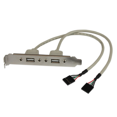

Or get one of these type:

I decided it's better to build an adapter, and not rewiring USB breakout cable.
Otherwise rewired USB cable may be later plugged into modern header by mistake and something may get fried or just not work.
Here it is, with criss-crossed wires on one side half of the adapter and straigt on the other.

Diagrams in post 2 and 3 are two different 10-pins header designs. They are similar in that left and right side halfs are rotated 180 deg, so that the plug can be inserted any side.
My motherboard (by Acorp) uses one from post 2.
On the other hand, "standard" USB 2.0 output cables use 9-pin design, where the plug can't be rotated, and left and right side halfs are electrically identical.

Aha, well... the reason pin 9 is key and meant to be blocked in the plug is so that you can't accidentally plug it into the old style 10-pin connector.
