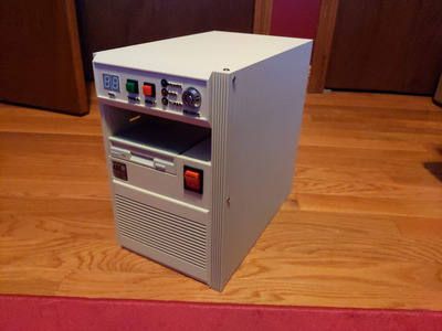

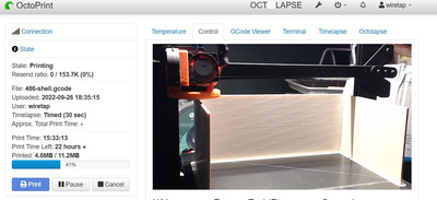

There are easily a dozen or more ways to make covers/lids for this. It's best just to try out something and see how it goes. With the U-design I'm printing right now, it is the motherboard side, top and bottom. Then all that is needed is a single sheet of clear plexi for the case window, and a rear plate for the card slots that can be designed last.

It fits perfect, minus a few screw hole offsets. I'll correct those and then upload the Sketchup/STL files.
edit: attached to post #2 of this thread.

Nice work!
I don't think that I have ever seen a floppy drive with a logo embossed on the bezel... 🤔 It is original or 3d printed as well?

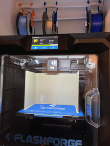

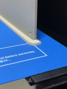

Reply 55 of 81, by oso2k

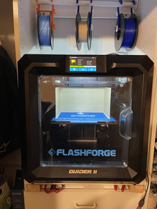

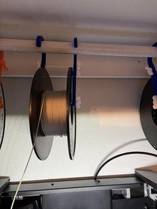

So I'm running out of PLA. A 1kg spool of Inland Bone White is not quite enough to print all 3 pieces. I'm going to have to test the Pause/Resume feature of my Guide II until the new spool I ordered comes in tomorrow.

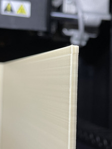

Reply 57 of 81, by oso2k

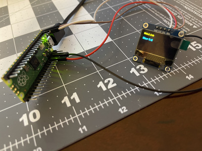

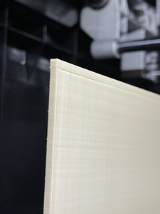

Did a quick test and I'm getting layer shifting but not horribly. I plan to print a couple more shells anyways. And my PicoTurboXT (working name) is waking up.
