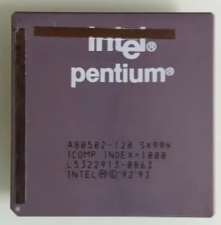

Reply 1 of 29, by jnemo2004
dear Sirs, somebody of you knows for what are used the metallic strips on a Pentium1-120. Thank you.

Idk what those metal strips are. They aren’t part of the processor.

Reply 8 of 29, by AlessandroB
The metallic strip i usually find in a Pentium cpu installed in a IBM socket5/7 computer. In my experience If you have a PPGA cpu (the black plastic version) 100% that the 166mhz version work perfectly at 200. I have a regule 166mhz and 200mhz version ad both work perfect at 200 without overvolting and at the same temperature. My opinion is that the cpu coma from the same wafer, just marketing to sold 166 or 200mhz primted on.
