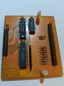

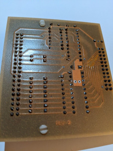

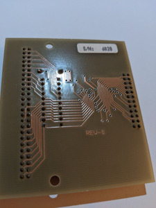

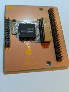

Reply 93 of 199, by GL1zdA
I'm adding the photos here, since they vanish from eBay after some time. None of these looks complicated, I guess the "interface" pins of the AdLib Gold are just a subset of ISA pins, probably the only thing Adlib is doing is managing resources. There were sound cards that had a socket for an NCR chip, AdLib and later MediaTrix loved daughtercards. These will probably sell for an insane amount of money and I doubt buyers will be interested in sharing them for reverse engineering, though as I said, they don't look too complicated.
    203.89 KiB
    2224 views
    AdLib CD-ROM Interface - Back
    152.61 KiB
    2224 views
    AdLib SCSI Interface - Back
    162.64 KiB
    2224 views
    AdLib SCSI Interface - Front
