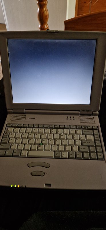

Hi all
I've got a Toshiba 4010CT laptop here which I'm trying to turn into a MS-DOS / Windows 3.11 machine.
After running fdisk, formatting and installing i am greeted by this on next boot:
It's a Pentium 2 machine with 40mb RAM and a 4GB CF card / IDE adaptor if thats of any help. Really unsure what im doing wrong.

Hi, I second what kixs says.
If it still doesn't work, you can try installing DOS 7.1 from the Windows 98SE CD-ROM for testing purposes.
That way, you can see if the CF card is detected correctly etc.
Some utilities not found on A:\ are in D:\WIN98 or D:\WIN98\COMMAND
- Sorry, can't concentrate right now.
Please note that Win98 FDISK is not fully compatible with DOS 6.2x, though.
FDISK /MBR works different internally, writes a DOS 7 boot sector, for example.
It may use LBA even if you want to use CHS settings in BIOS, will try to use FAT32 if it can (say "NO" to big HDD support) etc etc.
Btw, you can try to figure out drive geometry whit IDEDIAG or WHATIDE.

tried everything and a ms dos boot disk floppy none of works so i have no idea i just get that cursor even off a boot floppy so i've given up it will end up in the bin i expect.

They weren't, you have something wrong with your machine.
Try taking the hard drive out of the laptop and then attempt to boot with the floppy disk. It's possible the drive is not very happy.

It would be good to test your floppies too if it's possible they're not good. I usually MD5 the source image, write it, read it back, then MD5 the result and compare.
SITE NAME REMOVED has some other known good images you could try:
LINK REMOVED
Plop Boot Manager is also a good tool to try. Sometimes it will let you boot from devices the BIOS otherwise wouldn't boot from.
