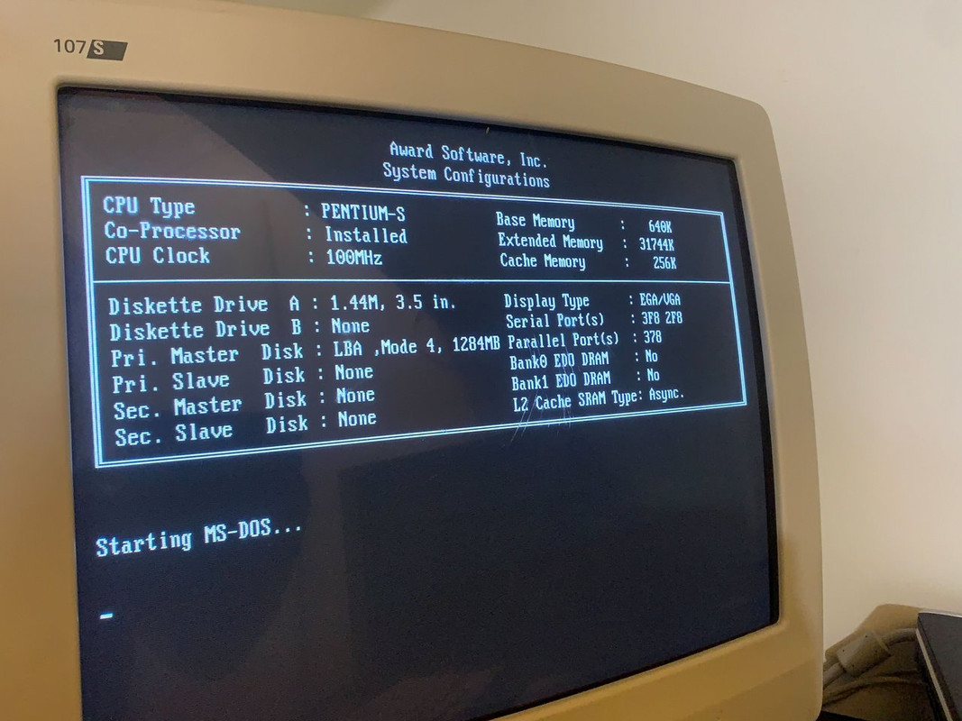

I tried overlocking the P100 to 120 (by setting multiplier to 2x instead of 1.5x) but the PC hangs after a few seconds. I also tried changing teh S3 video card to Tseng Labs ET6000 and observered similar results.
I checked the mobo jumpers and the p100 system is set to 66mhz with the 1.5 multiplier. Both systems have 256 cache.
In the system information program the p100 system reports 65Mhz (not 100). The BIOS post shows 100mhz.

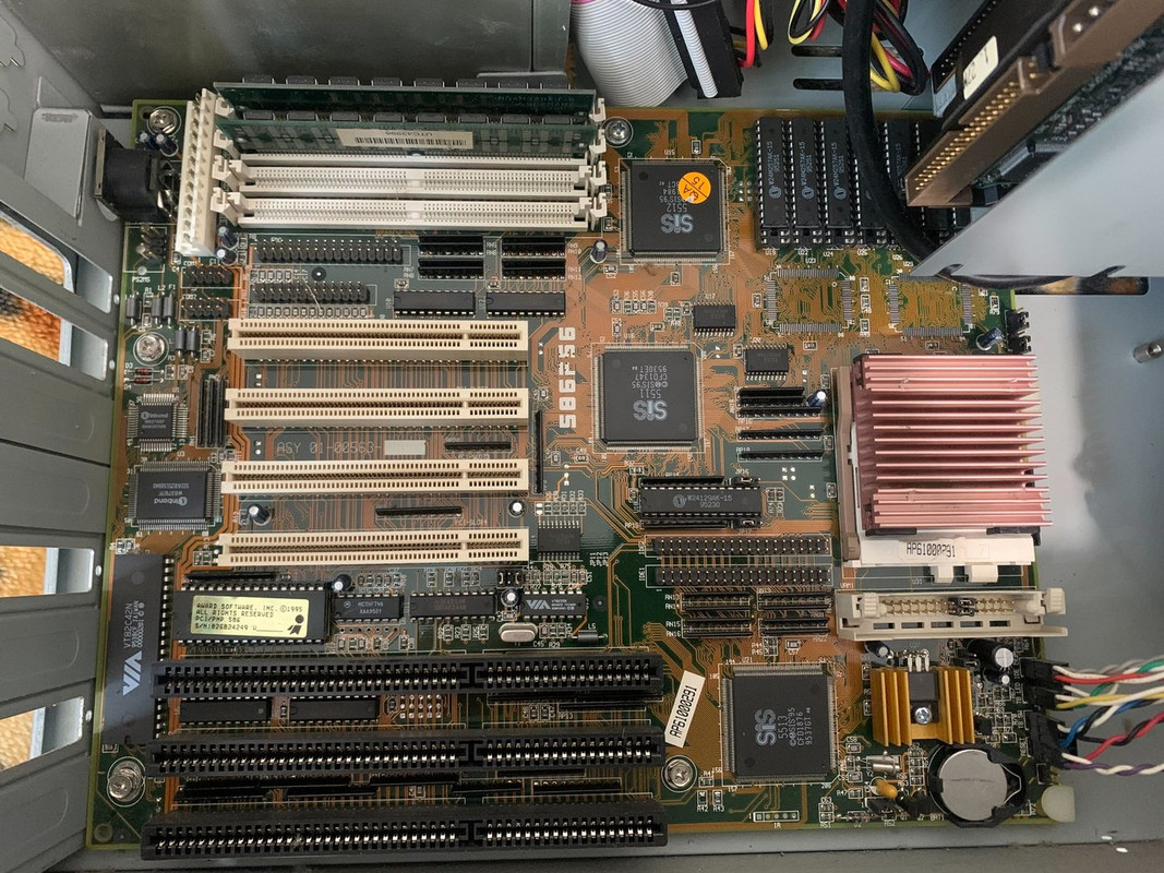

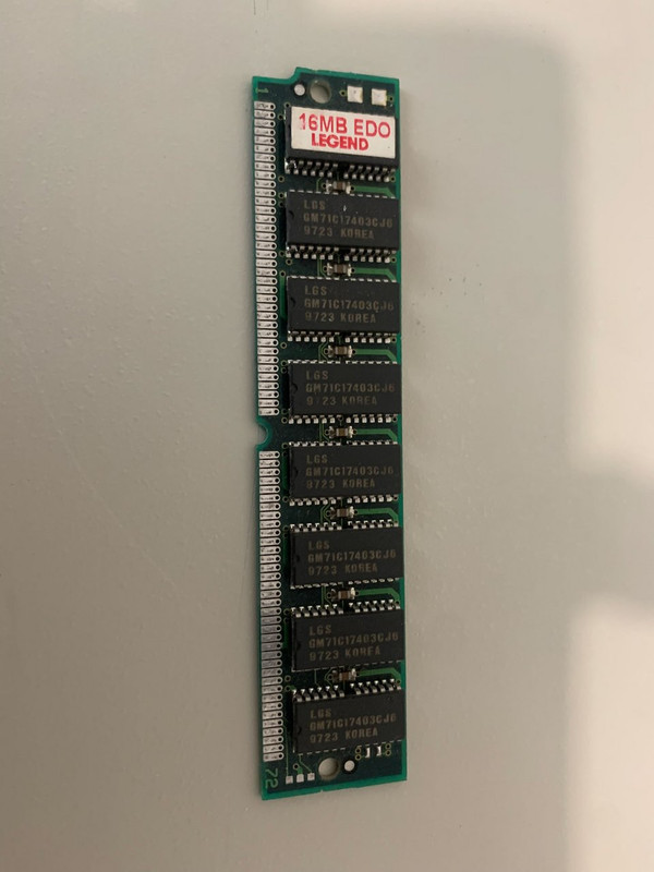

Reply 6 of 10, by darry
Something is probably off with the Pentium machine. I suggest you try other benchmarks.
Also, I believe this motherboard chipset (SIS 5511 or 5513) might be one of those that actually supports running with a single 72-pin. If this is the case and you are running with a single SIMM, this may explain the performance.

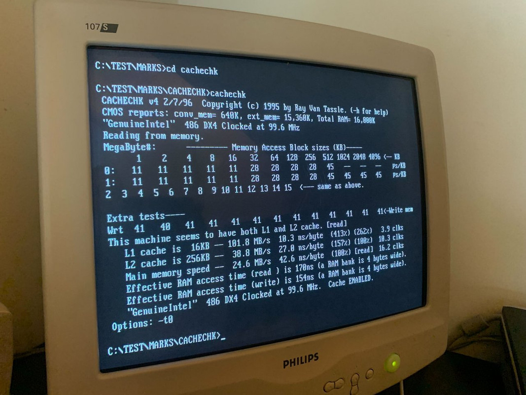

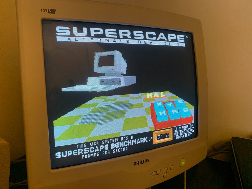

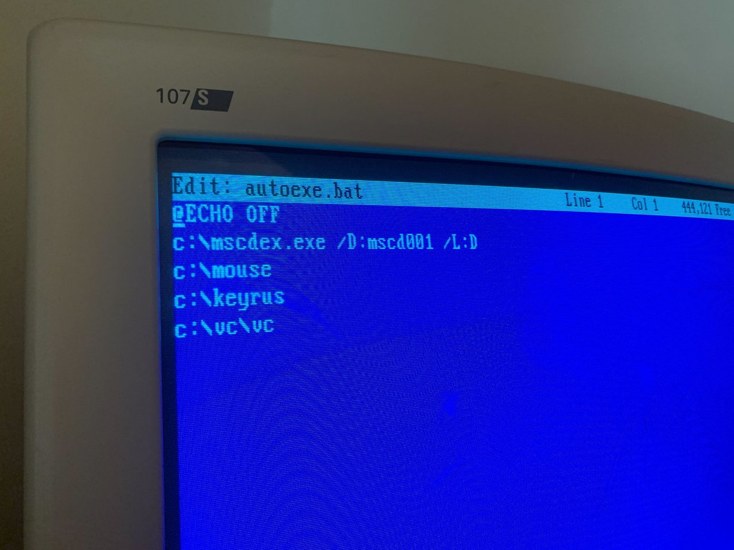

Hey, I didnt have photos - sorry about that.
I took some photos now - please see them below. After I assembled the PC back I thought: "Hmm what if I load just bare DOS 6.22 without anything in autoexec.bat and config.sys. So I did that and P100 returned much better results. My autoexec.bat and config.sys are very raw - I just got them off some CD that helped me to get my machines going. I still have lots of work to do with setting things up.
I just started getting back into retro pcs and dont remember many things from 90s. I guess loading stuff on boot like memory managers does affect things and skew test results.
I am now getting 71 for 486 and 91 for P100 in 3dBenchmark 1.0.
Below are the photos - maybe someone can pick something up that I am still missing:
Pentium 100, 32MB, 256 Cache, S3 Trio 64 V+
https://stason.org/TULARC/pc/motherboards/F/F … 6F56-VER-2.html
486dx4-100 , 16MB RAM, 256KB Cache, S3 Trio 64 V+
https://stason.org/TULARC/pc/motherboards/D/D … 86-EXP8449.html
AUTOEXEC.BAT and CONFIG.SYS
Thank you for your help.
