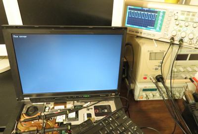

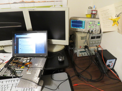

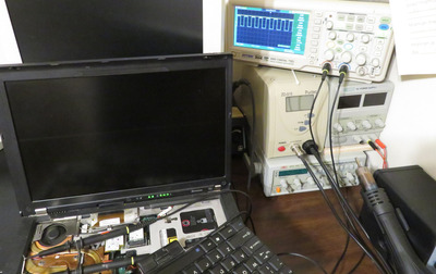

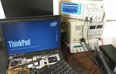

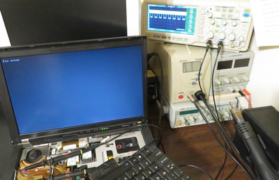

Here is the setup. It has been very difficult for me to work on anything with my wife's standing desk platform in the way. A covid purchase that stayed.
The attachment T61_setup.JPG is no longer available

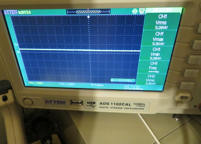

The fan's header is Vcc, GND, and Tach. For the purposes of the photos, I think yellow is fan power and blue is tach. I had swapped the colours around at some point.
Fan off here:
The attachment Fan_off.JPG is no longer available
Shortly after the fan turns on, some ringing for a few seconds:
The attachment Just_after_fan_turns_on_and_for_5-10_seconds.JPG is no longer available
After about 5-10 seconds, the ringing comes and goes, until it looks like this:
The attachment Fan_on.JPG is no longer available
Even with the fan on steady, every about 100 ms, you'll see a drop in the fan's voltage (not shown). Looks like the voltage drops from 5 V to about 2 V for a split second.
Sensors in Ubuntu still show fan at 0 RPM, even though we have a pulse wave from the fan's encoder. Bad microcontroller?
EDIT: And when the fan is sputtering really bad, you can see the pulse widths changing, like it stretching and contracting a spring.

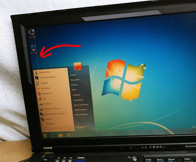

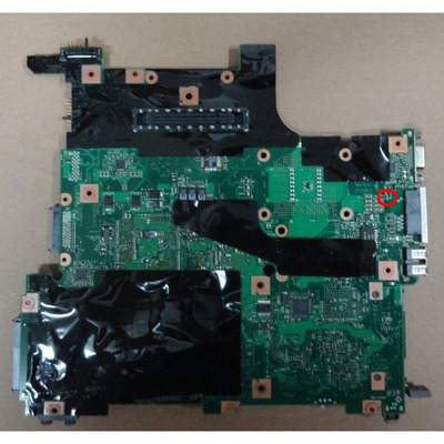

I've begun looking for some replacement boards online. What do you think the chances are that this pixel column imperfection is with the onboard Nvidia graphics controller? If it is an issue with the onboard graphics, then this board will be useless to me, but if it is the screen, then I'd just use my existing screen.
The attachment T61_replacements.jpg is no longer available
Reply 13 of 34, by dr_st
That's a screen problem (defective column driver), as far as I know. Seen it on several screens and it's never been the GPU. Can there be exceptions? Who knows. But it's not likely.

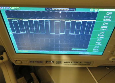

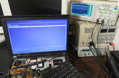

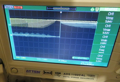

Immediately when the laptop is powered from a cold state, the encoder waveform is as follows.
The attachment T61_01_first_power_on.JPG is no longer available

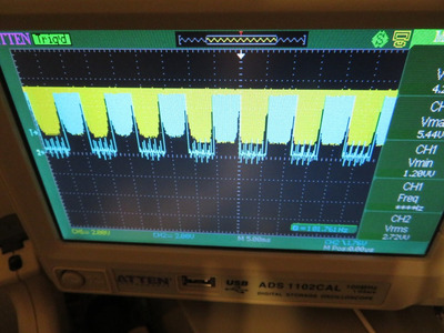

After a few seconds, the encoder's waveform develops noise as follows.
The attachment T61_02_two_seconds_after_power_on.JPG is no longer available
At the point of 'fan failure', the noise has continued to grow as viewed here:
The attachment T61_03_few_seconds_later_Fan_Failure.JPG is no longer available

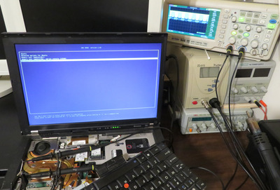

Press ESC, and at the GRUB loader screen, noise at its maximum a shown:
The attachment T61_04_press_ESC_and_sitting_at_GRUB.JPG is no longer available
Wait a few more seconds, and the noise disappears, seen here:
The attachment T61_05_waiting_a_few_seconds_more_at_GRUB.JPG is no longer available

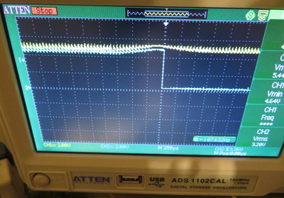

Reply 18 of 34, by feipoa
There is that transient noise I showed a scope image of earlier. It tends to go away after about 10 seconds of on time. Closer view of it:
The attachment Transient.JPG is no longer available
If I put a 1uF cap in parallel, not a lot of change, so I put a 100 uF in parallel and that transient noise disappears, but doesn't change the condition of 'fan failure'
The attachment Transient_100uF.JPG is no longer available
Reply 19 of 34, by rasz_pl
I just noticed oscillation is at 50us 20KHz, 47nF would be better at filtering that out. Maybe its as simple as pushing air made the fan backfeed into the motherboard, Mosfet is good for 30V and has some esd diodes buildin, but the 10nF C301 cap would just take it in the pooper and blow open, without C301 there is no filtering of the 20KHz visible on the scope and that messes up the KBC
try 10nF cap on fan input, and if that doesnt help another one on tacho output
