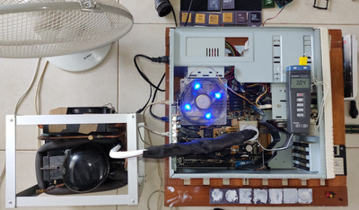

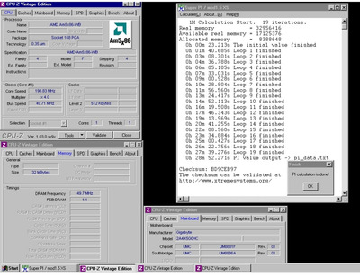

Some fun with my chipset Single Stage and AMD 5x86 P75 133 @ 200MHz @ 3.45v 😀

That's just a fun super overkill cooling setup. I love a good refrigeration based cooling build.

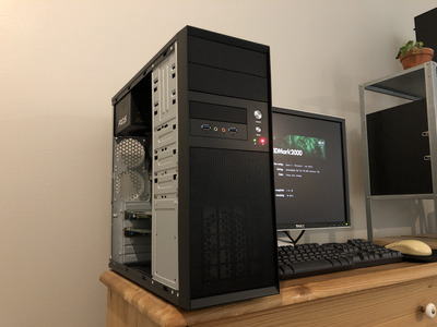

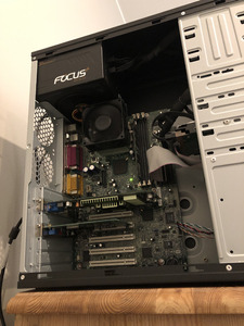

I've stashed nearly all the beige and quirky hardware away and this is the machine that gets most use, as it simply works.
PIII 866
512M 133 CL2
GF3
80GB HDD
W98 SE

Really clean build, would you mind to share the Brand/Model of that case? (I suppose its still available new?)

Chieftec CQ-01B-U3-OP
