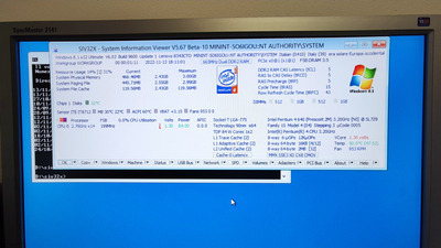

Reply 30 of 60, by biessea
red-ray wrote on 2022-11-13, 16:10:
biessea wrote on 2022-11-13, 15:45:
172 Windows 7 upgrades.
OK, one of the 172 will be KB4474419 so once they have finished SIV will be able to use its driver on that system.
Here I am with the update that you asked me.
I run from the DVD and went to restore. CMD prompt and run the 32x version (the 64x doesn't work in that state).
I put the photo of the results, the situation is always the same, I hope you have other ideas.

Reply 31 of 60, by red-ray
biessea wrote on 2022-11-13, 17:17:
Sill only one CPU 🙁 You used W8.1 x32 rather than W7 x32, but I suspect W7 x32 will also only have one CPU.
I can't think of anything else to try that would help figure out the root cause and fix it.

Reply 39 of 60, by Roman555
biessea wrote on 2022-11-13, 18:57:
Oh yes sorry, I am confusing a little bit cause I have another system than it's a Lenovo A55 and have all 4gb installed there.
In this system I have 3gb installed in four modules and dual channel enabled.
So I will try a Win 7 home edition, or perhaps a Win 10 too what do you think? It's a big shame to have Hyperthreading and don' t use it.
Now it doesn't matter which exactly edition of Win7 you're trying. Any edition should use more than one CPU cores (I don't remember about Win7 starter though 😀 ).
Personally I don't like Windows 10 because it likes to live its own life 😀 I understand that you think Win10 is usable and WinXP is not. Anyway I would try both 😀
biessea wrote on 2022-11-13, 19:13:
Horun wrote on 2022-11-13, 19:06:
It has to be something between the BIOS/chipset and the OS that is not seeing the HT (640) or dual core (D915) proper is the OS. Would be interesting to see what a Linux Live boot cd says........
And this problem hasn't never been out before? I am really surprised, cause this Lenovo Pc were sold a lot.
So no other ideas than try and try other OS?
Of course there is one more way: to desolder BIOS chip, find dump from type 8114 and flash it, solder PLCC32 socket and so on 😀 And it may not help too.
