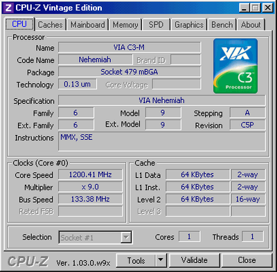

Reply 102 of 392, by elcrys
I can also confirm that VIA C3 1.2A runs on CUBX-E with the latest 1008cul004_20220218 without serious problems. As mentioned, temperature reading is wrong, but this is not an issue for me.
Thanks for the mod, this will make a very interesting retro machine.

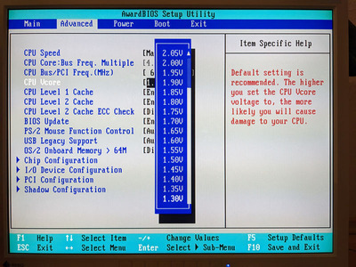

Reply 116 of 392, by BitsUndBolts
Hi DenizOezmen,
Thank you for your great work and the great BIOS for the ASUS P3B-F! I am using it and have no issues.
I recently made a video (Undervolted Pentium II) undervolting a Pentium II 400. The minimum voltage I can select is 1.55V - and the CPU is still stable.
I understand that there are voltage tables based on this post from you:
DenizOezmen wrote on 2021-09-12, 18:29:
Hmm, yes. I rebalanced the voltage tables a bit to enable the full undervolting range for cD0 Coppermine-T cores. The upper limit for 1.5V nominal voltage got lost in the process. I'll fix this.
Is there only a limited number of voltages that can be shown per CPU?
I was just wondering if it is possible to unlock more lower voltages or if there is a physical limit.
Thank you!
Reply 117 of 392, by DenizOezmen
Hi!
BitsUndBolts wrote on 2022-11-21, 11:13:
Thanks for the feedback!
Pretty cool video -- I wouldn't have expected such a low VCore to be usable. Also, it's interesting to see the exact point where the board applies the VCore setting.
Yes. The board supports all required as well as optional voltages of Intel's VRM 8.1 through 8.4 specifications, and the BIOS has one table containing all 31 of them:
3.50V, 3.40V, 3.30V, 3.20V, 3.10V, 3.00V, 2.90V, 2.80V
2.70V, 2.60V, 2.50V, 2.40V, 2.30V, 2.20V, 2.10V, 2.05V
2.00V, 1.95V, 1.90V, 1.85V, 1.80V, 1.75V, 1.70V, 1.65V
1.60V, 1.55V, 1.50V, 1.45V, 1.40V, 1.35V, 1.30V
There's no physical limit that I am aware of. The only limitation is GUI space. I'm not sure whether the dropdown menus support scroll bars, so I chose to go with the maximum number of lines I found evidence for, which is 16. (Sometimes only 15 are displayed, because there's a hidden invalid setting between 2.05 V and 2.10 V.)
So the BIOS basically chooses a maximum allowed (over)voltage setting depending on the processor VID and then fills up the rest of the list with as many entries as supported by the GUI.
I might try and see what happens when the 16 line limitation is removed.
By the way, you can alter and build the modified BIOS by yourself, if you like. You only need to download a copy of NASM, everything else is included in the archive. (Even if the GUI limit stands, lower voltages could still be unlocked by sacrificing a few overvoltage settings and simply shifting the voltage window downwards.)

BitsUndBolts wrote on 2022-11-22, 16:39:
I may give modifying the BIOS myself a shot in the future. I have a few replacement BIOS chips on the way - will be doing some experiments with hot swaps, boot blocks, and replace this EPA Energy Star logo...
I'll definitely bookmark this thread for its useful information!
Have fun!
In the meantime, I was curious and tried a build without the 16 line limit. Lo and behold - it scrolls! 😉
126.65 KiB
1239 views
I haven't actually tried the "new" settings, but don't currently see a reason why they would not work. You can give it a shot if you like:
