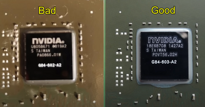

Reply 26 of 30, by schmatzler
Gmlb256 wrote on 2022-11-30, 21:02:
Xbox 360 was just poorly designed, so any chip will die in such conditions.
Doubt that the Xbox 360's RROD was caused by a poor design. Has a similar problem related to soldering, not a coincidence.
I believe the Xbox's RROD mostly happened due to problems with the die substrate of the GPU, not the actual BGA solder balls.
Jasper revisions of the console are very reliable (and less power-hungry) and people have successfully transplanted Jasper chips onto older motherboard revisions, reviving their consoles.
Those Nvidia chips dying have also been problems with the substrate. Heating the chips up fixed the problems temporarily, but there's no permanent fix for it, sadly.
Back in the day I had a Dell Latitude D620 with a GeForce Go 7300 that quickly died after a few weeks - a replacement motherboard didn't have that problem and it seems like Nvidia quietly fixed it without any official announcement. If I remember correctly, the only way to distinguish the non-faulty chips was the lettering on it, the Nvidia logo was slightly different:

Back in the day I had a Dell Latitude D620 with a GeForce Go 7300 that quickly died after a few weeks - a replacement motherboard didn't have that problem and it seems like Nvidia quietly fixed it without any official announcement. If I remember correctly, the only way to distinguish the non-faulty chips was the lettering on it, the Nvidia logo was slightly different.
It's all that transition to leadfree solder, ATI was also affected but it was less common, but plenty of R580 series cards died, plenty of R600 ect cards died as well. It was more obvious on the geforce 8 because most people bought a geforce 8, because the HD2900XT was a terrible card, it could almost compete with the 8800GTS 640 while requiring power beyond the 8800 Ultra. People noticed it because alot more 8800GTS 320 and 640 sold compared to what ATI had on offer, and honestly the 7900GS and GT where more popular than the x1900GT/x1900XT from my experince.
Reply 30 of 30, by schmatzler
candle_86 wrote on 2022-12-02, 01:58:
That's a common myth, but it's not universally true for all of the BGA chip failures mentioned here.
On the Xbox 360, it's definitely not the cause of the problem. It's the substrate on the chip itself, which is not soldered to the board at all.
