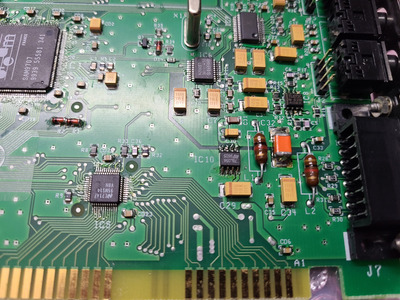

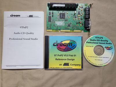

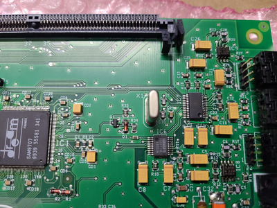

Well, this is pretty neat! This popped up for sale recently and after talking to the seller for a while he made me an offer I couldn't turn down. According to the seller, this came from an estate sale. The family of the previous owner said that they didn't know much about his old stuff, but he was an electrical engineer.
What it appears to be: Either a prototype or sample of a Windows 9x "studio" oriented MIDI card based on the Dream SAM9707 synthesis chip. It came with a CD and a manual (which appears to have been printed from a document included on the CD). It is an ISA card but seems to have been made sometime after 1998, with the latest dates being in 2001.
What makes it interesting: The SAM9707 is apparently a mostly drop-in replacement for the SAM9407 which is used on many highly regarded wavetable MIDI sound cards... however the 9707 seems to be pretty much unheard of online aside from a couple datasheets (which are also included on the CD). It apparently has some updated features, but I am not sure if they are anything that would matter for the average retro enthusiast. Also, the card has 2MB of onboard sample RAM (not ROM) and allows for a single SIMM up to 16MB, which came with the card, wrapped in a little antistatic baggy.
It seems that the device itself is made by Dream and was manufactured in France. The SIM memory also has French writing on it, so I would imagine that this card, CD and RAM were sent from Dream in France directly to a developer here in the US back in 2001 or so.

EDIT: After much trial and error, the card can work easily in DOS and Windows! Here are some highlights from the thread:
The card requires -5v from the motherboard\PSU to produce sound!

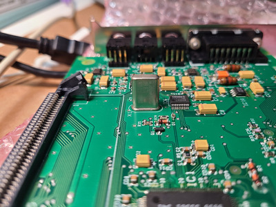

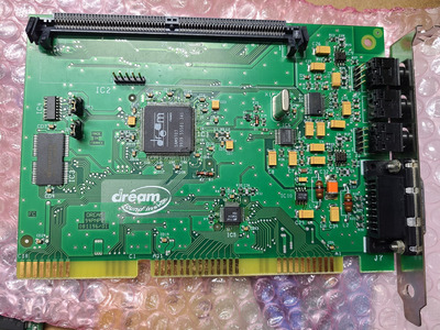

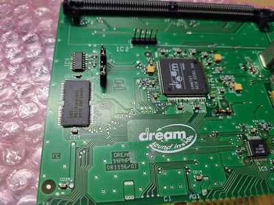

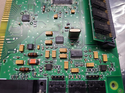

Here are some more close up pictures of the card.
It is also worth mentioning that the CD contains a lot of very interesting development related data, programs and documents regarding this device. It also contains information and files relating to this device's predecessor: the Dream 94PNP2. As far as I can tell, the 94PNP2 was probably identical to this (since this board actually has 94PNP2 etched into the PCB).

I would assume:
94PNP2 = SAM9407
97PNP2 = SAM9707
I went into this expecting the card to be an exclusively Windows oriented device (because the manual only mentions Windows 95 support and drivers), but managed to find some very interesting things on the CD that make me think it may be possible to get it to do more... but it will likely take some work.
Sadly, any further investigation of the card's capabilities will have to wait though because I cannot get the thing to make any sound! When I plug anything into the line-out jack on the card, the volume control on my speakers does that weird thing that happens when you plug speakers into a line-in by mistake... I get a strange fuzzy sound as I turn the knob and I can see my speakers physically moving very slowly. Under Windows 98SE I can install the drivers no problem. At bootup the chart showing the devices installed in the system clearly lists this card, detected as a PNP device (though it is not functional in DOS at this point). Playing back MIDI files in Windows 98SE appears to be working, but there is no audio coming out of the card. As far as I can tell, the diagnostic test applications for the card (on the CD) show that everything passes, but when it plays audio I just get some extremely faint alternating static noises from the Line-Out (sounds more like interference from other activity on the card). The Line-In does not seem to be outputting audio either, and the "surround" port gives a fairly loud repeating scratchy noise.

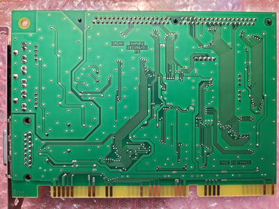

If anyone has any suggestions regarding the lack of audio output and the strange scratchy sound coming from my speakers when I adjust volume while connected to this card, I'd love to get it working. The board schematic (97PNP2.BMP) on the CD may help to diagnose it, but I'm not that good with circuits.
Also, there is one small bodge wire change on the card that I can spot... near the PCM3001E by the clock crystal (see the attached picture). As far as I can tell, the small round solder pad near the end of that wire has had a trace severed deliberately, and the trace goes under the PCM3001E diagonally. The bodge wire is soldered to that trace directly... seemingly to avoid connecting it to the tiny round solder pad.

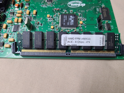

Yes, I believe it would require a sound bank, which the Windows drivers most likely load at startup... but the actual line-out seems to be either defective or misconfigured. As mentioned, the line-out responds the way a line-in does if you accidentally connect speakers to it, and it starts doing this as soon as the system is powered on.
Also worth mentioning, for those who are investigating the contents of the CD:
The hardware\PNP\ folder contains some really interesting stuff, but it does not appear to work at all with this particular card. I believe these are left-overs intended exclusively for the 94PNP2, not the 97PNP2. Basically, to configure the 94PNP's resource settings (presumably for DOS support), you have to write the information to a PNP EPROM on the card. The EPROM chip is the tiny square 95MS14 near the ISA connector. To do this, the "94PNP2.PNP" file must be edited with a text editor, then you run a .bat file which executes some external Microsoft Assembler and EXE2BIN applications (had to download these) to assemble and convert that file to 94PNP.BIN (ends up being only ~161 bytes in size). Then you run EEWRITE.EXE to write that file to the 95MS14 EPROM, which is supposed to change the configuration and resource allocation of the card for the next reboot.
It looks to me like the EPROM on this card has been resoldered, possibly by hand, so it could be a slightly different version from the one on the 94PNP2 or it could just have been replaced at some point. And it is worth mentioning that when experimenting with the above process to see if the card could actually initialize and be detected in pure DOS, it appears that the EEWRITE application does not interact with this card in any way. It prints ???? on the screen, says "erasing"(yeah, I actually felt pretty dumb\scared when I saw that), but never proceeds past that point and requires a reboot. Rebooting the system shows that the card is still detected as a PNP device and it is still detected in Windows, so it appears to not be able to read or modify the EPROM on this card at all.
After looking around a bit more, I realized that the 97PNP2.BIN file (in the root directory of the CD) which is nearly 1000x the size of the 94PNP2.BIN (in the PNP directory) is described in the manual as being the firmware for the card. Sadly, there doesn't appear to be any firmware editing or flashing tools\instructions for this newer version. Also, the manual says there should be a Firmware folder within the Hardware directory, but it does not exist on this CD... 😢
Any attempt to get the card working in DOS is either going to require messing with some software from other devices that have a similar setup (Dream SAM9x07 and PNP chip of some kind) or figuring out some way to modify the assembled 97PNP2.BIN file directly... which I highly doubt anyone with these skills will want to do, since this may be the only one of these that anyone will ever try to do this with.
But first, I need to figure out the line out issues.

Just a quick question to Ozzuneoj: Does your PSU supply -5V? Looks from the picture of the back side that the card have the -5V line connected and it might be the cause for a silent card if it's missing.
YouTube channel
Reply 15 of 72, by Ozzuneoj
Kamerat wrote on 2023-01-23, 23:21:
That is SO FUNNY! I just found that myself!! I was just going to post here that I'd fixed it less than 5 minutes ago by adding a -5V power adapter to my power supply!
I was looking at the schematic and saw that the TL072C Op-Amp had a -5v pin, and sure enough it traced all the way back to the -5v pin on the ISA connector. That seems strange now in terms of "retro" hardware because -5v was more common on much much older cards (PAS 16 and SB 2.0 come to mind), but at the time when this board was designed in 1996-1998 and even any of the later revisions in ~2000, it was still perfectly normal to expect a -5v line to be available on a power supply.
Anyway, this thing sounds great! Digital sound, MIDI... it's all there! I will tinker with it some more and post my findings.

I tried a 4MB stick of RAM and tried it with and without changing the memory size jumper and it still crashed. Interestingly, it reported the correct size even without the memory size jumper changed from 16MB to 4MB, so I'm not sure exactly what that jumper does. EDIT: Oh, Windows seems to freeze at a blank screen with a flashing white cursor if the jumper is set to 4MB with a 16MB SIMM installed. Good to know.
