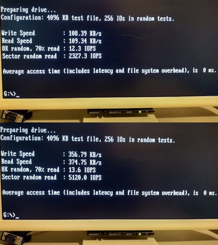

I tried it on my (486) IBM with a Pentium 83 MHz overdrive. The speeds went from 108 W 109 R to 365 W 375 R (typically). Much appreciated. 😀
143.58 KiB
1744 views
I tried setting the % to 1 and 2 but it just locks up when I try to do anything on the card. I also tried %255 and it corrupted the USB stick and I had to reformat it. 😀

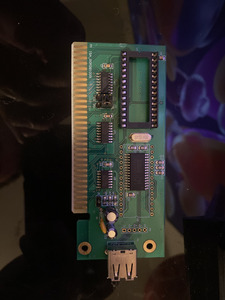

Look what showed up in my mailbox!
What do I need to know? Never used one before.
Should I get the ROM for it? Load xt-ide on it?

Reply 130 of 167, by FreddyV
Sphere478 wrote on 2023-01-27, 03:43:
Hi,
You can't use a ROM on it because the address lines are not decoded correctly.
I made an optimized version of the DOs Driver for this board, you can find it in this thread.

FreddyV wrote on 2023-01-27, 13:54:
Hi, […]
Hi,
Is there a way to hardware hack the socket to correct the problem?

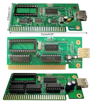

Want to order one on AliExpress but I see that there are 3 different versions (see picture).
First one is the bugged one. But what about the second and third one? The first 2 are about the same price. The 3rd one is about 50% more expensive.
Anyone got any idea which one is the 'best'?
