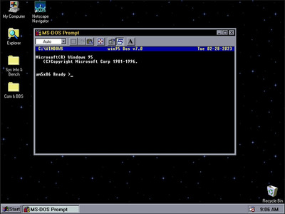

I used to use this back in the actual day and using it again today on my win95 box. It needs ansi.sys (or newer 3rd party ansi.com) loaded.
PROMPT $e[B$e[s$e[H$e[K$e[1;33;44m$e[K$e[1C$p$e[1;30Hwin95 Dos v7.0$e[1;66H$d$e[0;1;37;40m$e[uam5x86 Ready $g

Should be "Win Command Prompt" or "Win10 Command Prompt" as CMD.EXE from NT-based Windows versions has nothing to do with MS-DOS despite the console having superficially similar functionality. The 64-bit versions of Windows can't even run 16-bit applications at all by default.
Regardless, this is very nice with the current date being displayed! 😁
