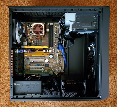

Reply 7 of 135, by Shponglefan
theiceman085 wrote on 2023-03-06, 07:45:
I want to cover the area from late 1997 to late 2000 if possible. There many possibilites to build the system but are some vendors preferable over the others are is it more a matter of personal preference?
There are a lot of different system builds that can cover that period of gaming.
Along the lines of what kolderman posted, my own build for this period consists of the following:
CPU: Athlon XP 2000+ (Socket A)
Motherboard: ASUS A7V600 (VIA KT600 chipset)
RAM: 512MB
GPU: GeForce4 Ti 4200
Sound cards: Diamond Monster MX300 (Vortex2) and Creative Labs Audigy 2 ZS (for EAX4)
Storage: 250GB SSD with SATA-to-IDE adapter
Removeable Storage: 3.5" disk drive and DVD-ROM drive
PSU: Sea Sonic Focus GX-1000
OS: Windows 98 SE
The intent of this system is to run Windows 9x era of games ranging from mid 90s to early 2000s. It's mostly components from about 2002 intended to play that era of games with good performance while maintaining good compatibility. For this reason I specifically used a motherboard with the VIA KT600 chipset since it also allows for compatibility for PCI sound cards with DOS games. I have used this system with games as old as the original Doom (1993).
You also don't need dual sound cards like I have. If I had to pick one, I would just use the Diamond Monster MX300 for its A3D support. You can't really go wrong with any Vortex2 based card or any of the Creative Labs Audigy cards.
I also use some modern components including a modern ATX case, fans, modular ATX power supply and SSD drive. Main reason is I want to run this computer cool and quiet, which is more easily achievable with modern components.
One more note regarding power supply: at 1000 watts it is overkill for a build like this. I chose it specifically because of the available amps (25A) on the 5V rail which is more necessary for older computer systems. If you were to use a more period-correct PSU, you could use one with lower overall wattage.
