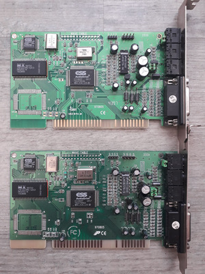

Hi everyone, new updates. I felt an urge to return the project as I have felt that my soldering skills got better. That and I don't like to leave things unfinished. On the picture below you can see the result of my work - BRB 233X card (is BRB a brand?) with ES982A ROM and ES690F synthesizer chip,. There was an ES689F chip before but I don't like dry MIDI personally. I have some spare ES690Fs and there is a convenient place for them on the card, so I had to do it. And everything finally works as it should.
These are the steps I want to do next, with dependency on the popularity of the project.
1. Make some recordings so you can hear what to bank sounds like.
2. Program a flash chip with the bank and replace the ES982A with it, perhaps try it on another card. Only if there is a demand for it.
496.43 KiB

Reply 25 of 70, by moturimi1
Paar wrote on 2023-03-11, 07:49:
Hi everyone, new updates. I felt an urge to return the project as I have felt that my soldering skills got better. That and I do […]
Really cool project.
By the way, is the image of ES982 that you provide in this thread correctly working?
Did you also test the ES689F + ES982A together?
I'd like to see if you can also make the card to work with a flashed MX2916 Flash chip instead of the original Mask ROM.
How does the card recognize which ROM is installed? On a Soundscape the card autodetects the installed ROM.
It would be great if you can make a sound comparison between ES981P and ES982A ROM.
I am looking forward to the progress of the project.
Reply 26 of 70, by Paar
I'm not sure what image you're referring to but the ROM from the last image works correctly. There's no need to set anything, the synth chip will recognize it properly. Perhaps there is some init info in the ROM header or something. And yes, you can use ES689F with it but I don't like it. Still, could be useful for cards where there're no pads for ES690F.
I'll make some recordings soon but I probably won't make any for the ES981P chip as there are plenty floating on the web already. You can listen to Serdaco's EWave wavetable board recordings too as it's basically ES690F and ES981P integrated into one chip.

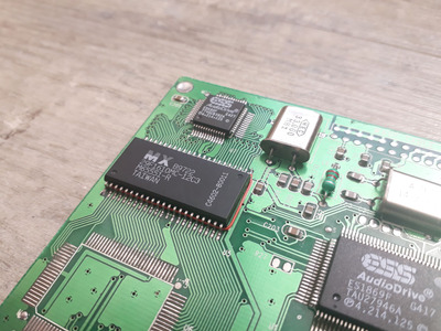

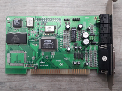

Reply 27 of 70, by Paar
Soldered the flashed ROM to another 233X card I had and success! Glorious MIDI music emitting from my speakers. Well, glorious in a sense that I'm happy the work was worth it. But it sounds better than regular 1MB ESS soundbank, at least to my ears. It definitely has the ESS vibe as the 1MB version but the music feels more quality. And no more redundant guitars in E1M1 – when using more robust sound banks, you can hear that the guitar that starts on one channel and the second guitar that follows on the different channel sound different. With small soundbanks both guitars often sound identical.
Had to solder a small wire from WE pin (pin 1) to VDD to set the ROM to read mode as the pin 1 is normally NC on ES981/ES982. It's possible to route it in the way it's almost invisible so I'm OK with that.
Since the mod worked great I retroactively swapped the chip on the first card as I want to have the original chip at my disposal. Perhaps use it with some nicer card than 233X.
Now onto some recordings. Hopefully I'll have them ready soon.
691.63 KiB
1796 views
409.78 KiB
1796 views
