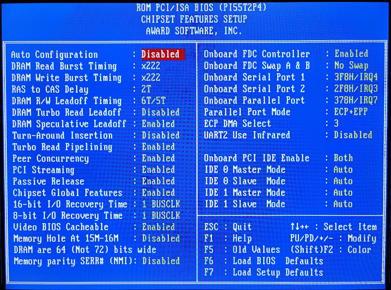

Now that the CMOS settings can be saved again, it is time to choose a CPU. I want to do all the CPU tests on a test bench so it is easier to access jumpers and change CPUs. I'm going to test Pentium 133, 150 and 166. Just for comparison, I think I'll test MMX 166, 200 and 233. And Cyrix 6x86L pr200+. I would have very much liked to test Pentium Classic 200 as well but I do not have it. Pentium 166 was multiplier locked (I tried) so best I can do is to test 75 * 2.5 = 187 MHz. It will most likely be faster than 200 would have been.
First thing to do is to find a fastest possible memory timings for the CPU tests. And 75 MHz bus turns out to be a bit problematic. I started memory tests with memtest86 3.5. I had the disk close. It is a good version since it works on a 386. Somewhere during the testing I decided to use memtest86+ (some 4.x) and it started to reveal problems. In fact, even the BIOS defaults for 60ns had errors. I need to do more testing. Nothing was overheating, although the RAM and chipset got warm. Cache chips didn't even get warm but maybe memtest disabled L2 cache. I was surprised how cool the overclocked CPU was. After all the testing, I removed the heatsink to try how hot the CPU was.
Next I need to test the SIMMs one pair at a time in case the other pair just does not like 75 MHz. Or maybe I should do the memory testing with 6x86 since it is meant to be used with 75 MHz bus.
Reply 14 of 85, by aitotat
I found out what the problem was. The tested 166MHz CPU is one of those that use "VRE" voltage. So 3.5V instead of more typical 3.3V. No wonder there were problems since the CPU was undervolted and overclocked at the same time. AMD and Cyrix have properly printed voltage requirements on the CPU but it is not so easy with classic Pentiums.
Now 60ns default timings work fine and I can continue finding fastest stable settings.
Reply 15 of 85, by aitotat
Memory testing continues but not without problems. Faster timings (faster than the 60ns default) produced single error with the Pentum 166@187MHz. It might have come at the second pass so quite random error. So I decided it is better to test with non-overclocked CPU. I could have used the Cyrix but that v4 memtest likely uses Pentium instructions not supported by Cyrix 6x86. So I skipped that and decided to test with Pentium MMX 233. It is not multiplier locked so I can use 75 x 3 = 225 MHz.
I also updated BIOS to the latest. I should have done that from the beginning as it might affect those timings. Motherboard had version #401A0-0109. There is 0207 with patch to support drives up to 128 GB. I decided to use that. I tried 3 different versions of awdflash but couldn't flash the chip, or more likely awdflash couldn't identify it for some reason. I had to use EPROM programmer instead. It didn't support that flash either since my programmer is older than this system I'm building. But I managed to flash it anyway as I found compatible Atmel flash settings that worked. This motherboard has Winbond flash in it.
Now I decided to test with L2 cache disabled in case it might affect the testing. Everything went really well.
Here are the stable settings for 75 MHz (with L2 cache disabled)
-LtIh2k3xkIjXqeKOx4SjkGHYblvXXRpIoKa0S0hXXOa-euhd5GC9RTX3lB_yAHx--Q=w2400
DRAM Turbo Read Leadoff must be kept disabled since Memtest does not even start with that enabled. But other than that, just excellent!
So just one more test with L2 enabled to make sure everything works. And errors right away. For some reason cache is not happy with those settings. Is it 75 MHz speed that is the problem? Is is one of those settings? Is it the extra TAG SRAM I installed? Now I must test those one thing at a time. Why can't things be easy for once?
Reply 16 of 85, by aitotat
Here are fastest stable settings for 66 MHz (above) and for 75 MHz bus (below)
aNri0WA426cuBh1HxoZSMXB719vt9K_VVd7D8y-hWVAMEvO2YEXITchSEsnyk9Zeb9c=w2400
pIJuHMVHqWxwi9NsOK-OVQ0O5GZQYd4EmcppaSp0RwpQV7GmhFOA-C9Hi5yhpPSf9kQ=w2400
So there was just one setting that was too much for 75 MHz, RAS to CAS delay. It can be 2T for 66 MHz bus but needs to be 3T for 75 MHz bus. All other settings can be equal. Also it might need second memtest86 pass before the problems start to show up. So 2T for 75 MHz is just and just unstable. My guess is that the problem is with those 15ns TAG SRAMs. I'm sure 2T would be fully stable with 12ns SRAMs. I tried to remove the extra TAG SRAM I added but it did not change anything.
What do those BIOS settings mean. For excellent information, search PC engineers reference book on archive.org.
Here are what it says about those settings
Turbo Read Leadoff
Sometimes needed for faster memory, and disabled by default. When Enabled, the BIOS skips the
first input register in the DRAM when reading data, speeding up the read timings. In other words, it
shortens the leadoff cycles and optimizes performance in cacheless, 50-60 MHz, or 1-bank EDO
systems, but it is known to speed up those with a 512K Level 2 Cache and 2 banks of EDO (2X16,
2X32 Mb SIMMs), especially when copying data, such as when backing up a hard drive. However,
after a few hours of use, errors start in applications and when loading data from the hard drive,
especially when switching between applications. Suggest enable this for games, but disable otherwise.
See also Read/Write Leadoff.

Chipset Global Features
Applies bus mastering to all PCI slots, assuming all cards are compatible.
So it is best to keep DRAM Turbo Read Leadoff disabled, so no need to worry memtest86 did not start with that enabled. I also disabled Turn-Around Insertion that I previously had enabled. Disabled is faster since enabling it adds wait states. And since it is disabled by default, there should be no need to enable it.
Just one setting, Passive Release, is something I don't know yet should it be kept disabled or enabled. It might be that ISA sound cards work more nicely with that one disabled. But we'll see.
So we now have 128 MB RAM with fastest possible settings. Great! Time to choose the CPU next. Lots of benchmarking to do next week... But before starting those, I should select some video card for the tests. I'm going to use the one that most likely stays on this computer.
