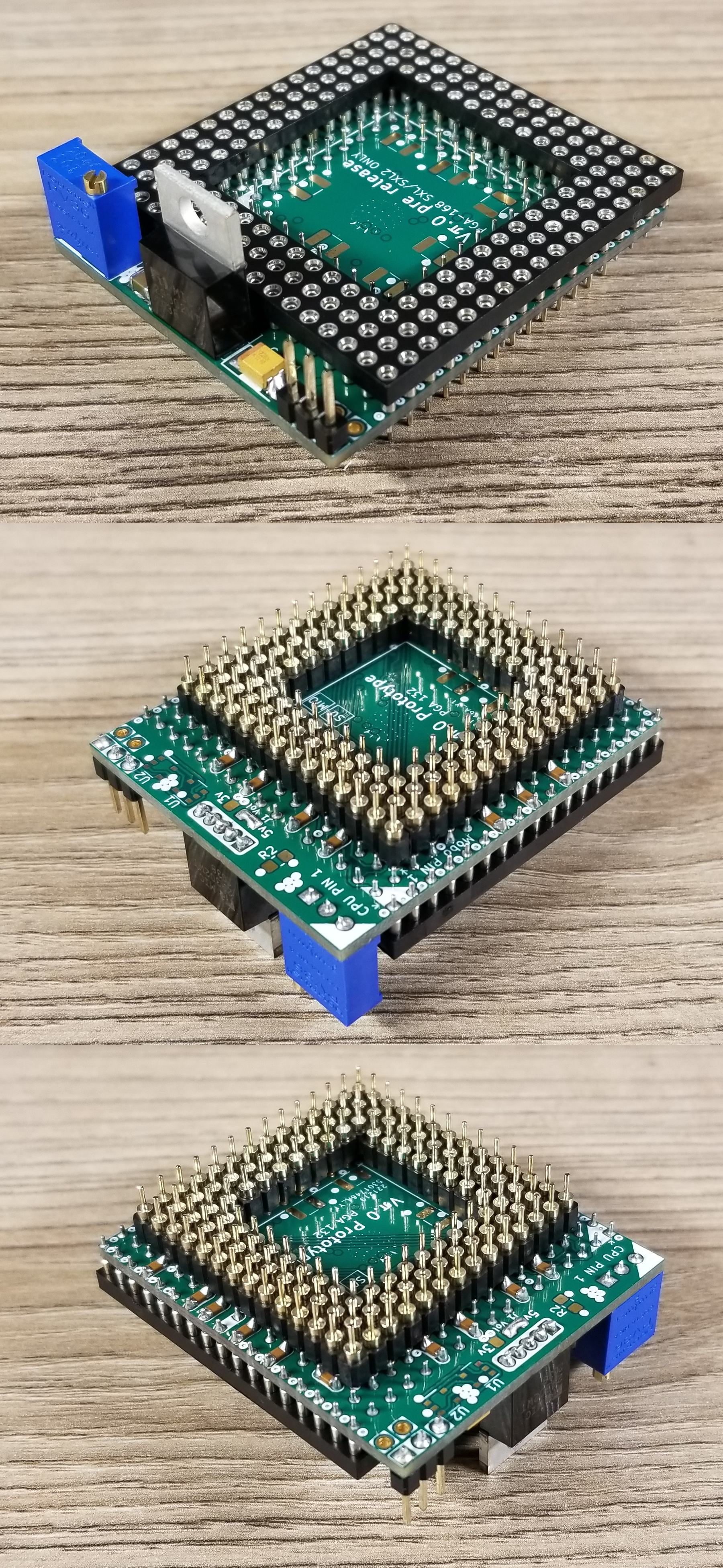

Alpha 2 - round 1
LP38501TS-ADJ
Cin = 10 uF cer
Cout = 22 uF tant
Vout
5 KHz : Vpp = 426 mV OUTCH!
Alpha 2 - round 2
Cin = 10 uF cer
Cout = 22 uF tant
added PGA-168 pins, Cout = 8x 100 nF
Vout
5 KHz : Vpp = 128 mV
Vin
5 KHz : Vpp = 92 mV
Alpha 2 - round 3
Cin = 10 uF cer
Cout = 22 uF tant
added PGA-132 pins, Cin = 5x 100 nF
Vout
5 KHz : Vpp = 128-140 mV (no change)
Vin
5 KHz : Vpp = 70 mV (reduced by 22 mV)
Alpha 2 - round 4
Cin = 10 uF cer
Cout = 22 uF tant
PGA-168 pins, add Cout = 8x 100 nF
PGA-132 pins, add Cin = 5x 100 nF
added 7x Cin caps central region, values were: 1x 10 uF, 3x 1 uF, 1x 220 nF, 2x 10 nF,
Vout
Vin
5 KHz : Vpp = 55 mV (reduced by 15 mV)
Alpha 2 - round 5
Cin = 10 uF cer
Cout = 22 uF tant
added PGA-168 pins, 4x 1 uF, 4x 22 nF
Vout
5 KHz : Vpp = 84 mV (reduced by 51 mV)
80 MHz : Vpp = 40 mV (no change)
Vin
5 KHz : Vpp = 55 mV (no change)
Alpha 2 - round 6
Cin = 10 uF cer
Cout = 22 uF tant
PGA-168 pins, add Cout = 8x 100 nF, 4x 1 uF, 4x 22 nF
added PGA-168 pins, 2x 100 nF
Vout
5 KHz : Vpp = 82 mV (reduced by 2 mV)
Vin
Alpha 2 - round 7
Cin = 10 uF cer
Cout = 22 uF tant
PGA-168 pins, add Cout = 10x 100 nF, 4x 1 uF, 4x 22 nF
removed all 7x Cin caps central region
Vout
5 KHz : Vpp = 82 mV (no change)
central region's 1210-sized Cin caps have no effect on Vout
Vin
5 KHz : Vpp = 60 mV (increased noise by 5 mV)
Vin noise increased by only 5 mV after removing central Cin caps.
Alpha 2 - round 8
Now comparing with MIC29302WT regulator to see if central Cin caps help in any way
Cin = 10 uF cer
Cout = 22 uF tant
Vout
5 KHz : Vpp = 86 mV with or without central Cin
80 MHz : Vpp = 34 mV with or without central Cin
Vin
5 KHz : Vpp = 54 mV with Cin central caps and 62 mV without Cin central caps.
The conclusion from this round of testing was that adding 7 Cin central MLCC capacitors does not help Vout at all and helps Vin by only 5-8 mV. Cout central caps had been removed from Alpha2's design, thus determining their benefit, if any, was not measured.
Alpha 2 - round 9
Assembled a second w/MIC29302WT regulator, but with only 100 nF caps.
Cin = 10 uF cer
Cout = 22 uF tant
PGA-168 pins, add Cout = 18x 100 nF
Vout
5 KHz : Vpp = 84 - 94 mV
Vin
5 KHz : Vpp = 50 mV
Conclusion, the MIC29302WT regulator showed similar noise characteristics to that of the LP38501TS-ADJ. The LP maybe demonstrated every so slightly less Vout noise, but this is within measurement error. The maximum output voltage from the MIC regulator under full load was 4.81 V, while it was 4.92 V for the LP regulator. The central region's Cin caps do not reduce Vout and only reduce Vin by an inconsequential 5 mV.
By way of comparison, I remeasured the Improve-It + Gainbery interposer's noise with the SXL2, and noted,
Vout
5 KHz : Vpp = 180 mV
80 MHz : Vpp = 96 mV
Vin
5 KHz : Vpp = 140 mV,
thus the Alpha units demonstrated improved noise characteristics. Ideally, we'd have noise values from the Powerleap unit to offer a fairer comparison. Note that we have not checked for noise and reflections on any of the other pins, like address, data, HLDA, etc. Since we having a working unit at 80 MHz already, I do not see any value in this.
Here is a scope capture of the noise on the MIC29302WT:
75.63 KiB
1288 views
And the scope capture of the noise on the LP38501TS-ADJ:
78.12 KiB
1288 views
Shown in this image are the locations and values for some of the capacitor experimenting I did w/LP regulator:
216.43 KiB
1288 views
However, results with all 100 nF caps were just as good. This is what I have, overall, ended up with for PGA168 capacitors and locations. You will see some locations that are not utilised. I tried adding caps to these non-utilised regions, but it did not improve the noise response, and so these caps were removed. In general, having adjacent PGA168 caps do not help the noise response. You will notice that I added a cap to VCC5 on PGA168, mostly because I had some extra caps. Here is the final layout, but I think using only 8x caps is more than sufficient:
188.11 KiB
1288 views
Here are the caps I placed on the PGA132 pins to serve as Cin. There are only 5 locations which are convenient for soldering. It is more than sufficient. Central core caps not needed.
189.16 KiB
1288 views
I am not sure what JLCPCB changed to cut costs on their $2 6-layer boards (Alpha2), but my general impression was that the build quality on the non-cost-reduced boards at $85 (Alpha1) were a little better.
FINAL NOISE of Alpha2 w/LP38501TS-ADJ
Vout
5 KHz : Vpp = 82 mV
Vin
5 KHz : Vpp = 55 mV

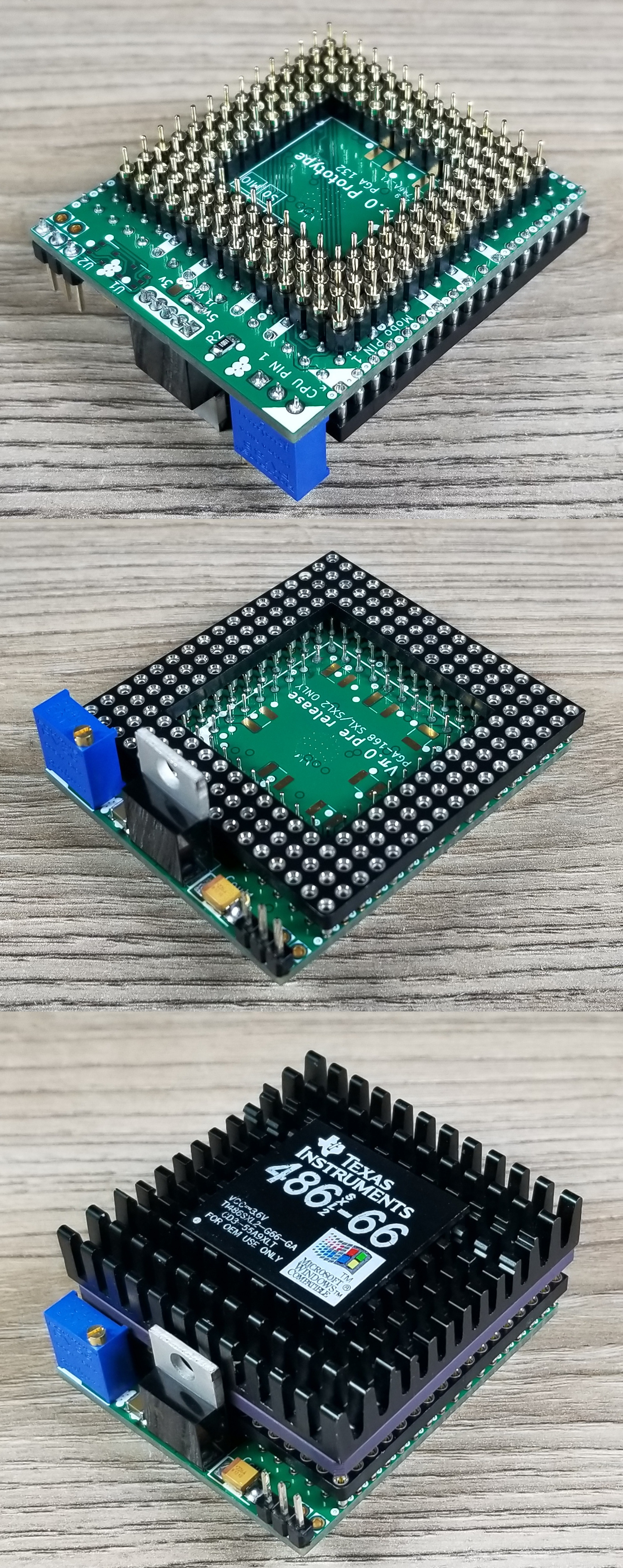

Reply 904 of 1201, by feipoa
Here is the final product with fan attached:
215.48 KiB
1287 views
There had been some comments on pin alignment concerns. Here is a photo of the pins lined up. Generally, during assembly, you want to have the pins in a spare PGA132 socket to keep them straight. You may also need to lightly sand the ABS between the pin rows and ends to make for a nice fit.
320.68 KiB
1287 views
Here is a view of the top to show the Cin 0805, 100 nF caps on PGA132 pins. Note that the 1210 caps are still installed in this photo:
288.62 KiB
1287 views
Here's a view of the bottom with Cout 0805, 100 nF caps:
280.9 KiB
1287 views
While you could use 0603 capacitors and place them down onto the PCB, for ease of soldering, I would just take 0805 caps and press them into the PGA168 pins, just far enough to hold them in place and solder.
Next on the agenda was binning. I have 13 SXL2-66 CPUs.
976.54 KiB
1287 views
It took quite some time to determine the maximum frequency at which voltage for all the CPUs. Of the 13 CPUs, only 2 wouldn't run reliably at 80 MHz. The other 11 ran at 80 MHz, but voltage was important. The results are shown in the image, but I will provide them here as well.
CPU-1
Max freq: 75 MHz
Min voltage required: 4.15 V
CPU-2
Max freq: 75 MHz
Min voltage required: 3.65 V
CPU-3
Max freq: 80 MHz
Min voltage required: 4.20 V
CPU-4
Max freq: 80 MHz
CPU-5
Max freq: 80 MHz
Min voltage required: 4.10 V
CPU-6
Max freq: 80 MHz
CPU-7
Max freq: 80 MHz
Min voltage required: 4.05 V
CPU-8
Max freq: 80 MHz
CPU-9
Max freq: 80 MHz
CPU-10
Max freq: 80 MHz
Min voltage required: 4.0 V
CPU-11
Max freq: 80 MHz
CPU-12
Max freq: 80 MHz
Min voltage required: 3.95 V
CPU-13
Max freq: 80 MHz
Min voltage required: 3.85 V
Max freq: 90 MHz
Min voltage required: 5.0 V
My testing criteria was to run the DOOM and QUAKE timedemos to completion, then let Quake run in a loop for 30 minutes. Reboot, then load Windows 3.11, open IE5 and load a google search result.

Reply 918 of 1201, by feipoa
Were you also planning to add the PGA capacitor pins to the top as well?
I noticed that you mounted your male-male PGA pins opposite to mine. I am curious, what was your rational behind this? The reason I mounted my pins in the orientation shown in my images was because of the pin length, pin width, and ability to use a CPU removal tool.
The end of the PGA header with the wide pin base is too wide for a PGA CPU removal tool to be used. The side with wide base is also shorter (3 mm) than the longer side (4 mm). I find that 3 mm is just barely long enough to click into the motherboard's socket and maybe this will limit your lateral contact area, or make the CPU more prone to fall out on a side mount. The other reason was the width of the pin on the wide base end, which is 0.58 mm , compared to 0.45 mm on the long side. If you measure a standard Intel i486SX or Am386DX pin width, they are 0.43 mm wide. So in using the wide side of the PGA header for socket mating (0.58 mm), you may stretch out your motherboard's PGA132 sockets.
These were all the issues I considered when selecting the side to use. Since you used it in the opposite direction, I am wondering if I overlooked something more important? If so, could you let me know?
Reply 919 of 1201, by pshipkov
Not sure what you mean by “add the pga pins to the top”.
The pga132 pins are oriented that way on most adapters i have seen.
I dont have cpu removal tools, so your notes a bit ambiguous. But i think i understand what you mean.
Also, if the pins are oriented that way, insertion and removal is much easier, yet the adapter sits firmly in the socket when inserted.
Btw, where you measure for noise levels ? Can you confirm, so i do the same here for conformity.
Last note - silk screen on these PCBs can easily crack and chip away.
It requires precise and gentle handling.
