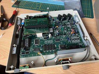

Reply 34 of 40, by AndreStarTrek
Testing
Stored the original components in side the case.
Succes, it works perfectly, I am so happy now. Got this one because the CM-32L was way to expensive, I knew this one had this bug but I got it for a nice price. But alway on the lookout for the CM-32L. But now I have the best CM-32L you can buy, because there almost no noise in from the cm-32ln.
rasz_pl wrote on 2023-12-16, 05:31:
There is nothing special about 8MHz quartz crystal needed for this Roland unit. You dont have to worry about origin country, they are made using positively ancient manufacturing process - 50-100 years depending how you look at it with very little change. Even in the seventies poor countries under russian occupation were manufacturing perfectly good components despite huge technological gap.
I ordered the generic crystals from Aliexpress that i post before and they work perfectly, so indeed notting special and much much cheaper thanks 😉

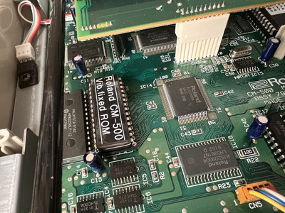

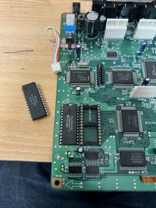

Reply 36 of 40, by Salient
FInally I am in the process of doing this mod to my CM-500.
So far succesfully desoldered the original chip, put a socket in its place and verified everything was still working (which it was luckily).
Second step was dumping the original ROM, which seems to have worked because I flashed this directly to a 27C512 and this works perfectly when installed in the CM-500.
I'm a bit unfamiliar with using IPS files. What I did was using Lunar IPS, which is usally used for patching snes/gba and such rom files with IPS files, flashed the modified version to a ROM and tried it.
With this version it doesn't work but I must mention I still have the default 12MHz xtal installed. My guess is that MIDI is now broken because of the modification. Can't test this right now because I don't have an 8MHz xtal handy.
Would Lunar IPS actually work to do this mod or are you guys using different a different approach?
Reply 37 of 40, by keropi
Lunar IPS will work fine applying IPS patches to any file
the 8mhz xtal is required because as you have guessed it timings are not different
🎵 🎧 MK1869, PCMIDI MPU , OrpheusII , Action Rewind , Megacard and 🎶GoldLib soundcard website
Reply 38 of 40, by Salient
keropi wrote on 2024-05-09, 13:53:
Installed an 8MHz xtal and works as expected! Great stuff!
