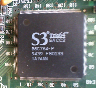

Can you show the photo of ISA S3 Trio64?
I would if I had one, do you know of one for Windows NT 4.00 SP6a please? I am currently using V4.00.1381.164 that came with Windows and was built on 1999-02-11 @ 21:31:12.

I wanted a photo of the card as I never heard Trio64 would support ISA bus. Only VLB and PCI.

Reply 48 of 79, by Disruptor
red-ray wrote on 2023-03-31, 19:03:
kixs wrote on 2023-03-31, 18:50:
It's on the motherboard.
Thanks for the photo.
But how can we be sure that it is ISA then?
I'm sure it is local bus then.
Reply 49 of 79, by red-ray
Disruptor wrote on 2023-03-31, 19:05:
But how can we be sure that it is ISA then? I'm sure it is local bus then.
I guess we can't, I assumed it was ISA and there are no VLB slots on the motherboard.

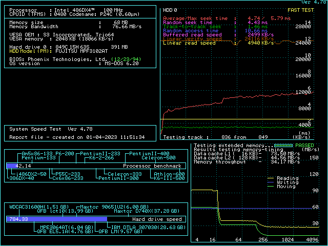

In 1994 there was VLB and PCI. ISA was on the way out. To get a feeling on what bus is connected try a Speedsys and the VGA transfer speed will indicate what it is. If it's less then 4MB/s== ISA. VLB or PCI should be around 10MB/s or more - it depends on the motherboard too.
Visit my AmiBay items for sale (updated: 2025-03-14). I also take requests 😉
Reply 55 of 79, by red-ray
kixs wrote on 2023-04-01, 06:49:
Looks like it must be VLB and guess 18 MB/s is quite a respectable speed, is it?

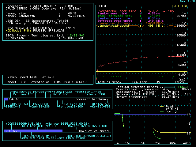

Reply 57 of 79, by red-ray
kixs wrote on 2023-04-01, 10:02:
Actually I get 17MB/s on VLB and 18MB/s on PCI bus. It's definitely not an ISA bus 😉
I just changed the CPU and it's still 18 MB/s, I wonder why you only see 17 MB/s, which CPU do you have?
I don't think it can be PCI as the SiS 471 does not support PCI and SIV does not see any PCI devices.
