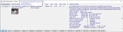

Reply 11 of 23, by red-ray
Minutemanqvs wrote on 2023-04-02, 18:19:
Bottom line: use a glide wrapper if you are sensible. Buy one if you have an emotional attachment to it.
No, that does not work for me. I fancied one so I could get SIV to report it and to sensibly do this I need the real thing.

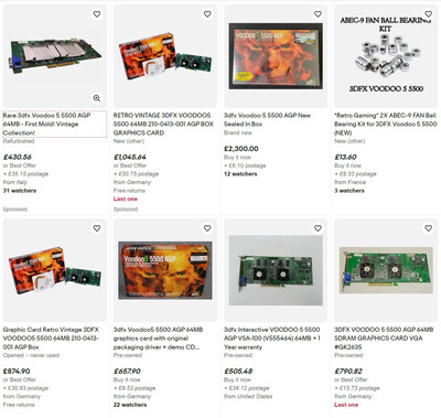

Reply 15 of 23, by andychak
The Voodoo 5's are crazy expensive right now; I've attached a screenshot of prices from eBay
The attachment voodoo5prices.jpg is no longer available
Meatball wrote on 2023-04-02, 21:15:
I'm of the opinion get an original Voodoo and a Voodoo5 5500 - everything else in between - skip unless you're a collector or trying to build a nostalgic or period correct machine. Be on the lookout for deals - the most prevalent are from people who don't know/don't care what they have and just throw them up for sale.

Reply 17 of 23, by Meatball
andychak wrote on 2023-04-02, 21:23:
Yep. Like I said, be on the lookout. About a month ago, I bought one on eBay for $35 and I just happened to be perusing the site when it was listed. I understand this is a lightning strike, but it happens - likely one will show up in the $150 - $250 range soon rather than later on eBay. Another member, cyclone3D, I think, picked up a working unit in a pile of scrap for a steal around the same time.
Otherwise, either pay the $300-400 when one shows up around that price and enjoy life (time is more valuable than money - you can always get more money... always). Or go to emulation. They won't be getting cheaper.
