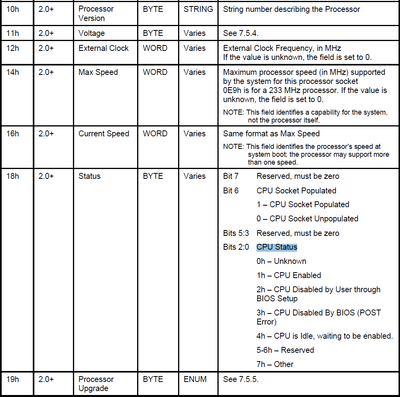

Reply 22 of 64, by red-ray
Mamba wrote on 2023-04-02, 18:32:
MPS 1.4
Good, but Menu->Hardware->BIOS Tables->MPS will say more.
Looking at [Machine] I can tell is CPU is present, but thinking back to the AIDA64 screen I guess it's disabled.
file.php?id=161387
As you can see there are multiple reasons it could be disabled, I wonder which one is it? My guess is that it's Disabled By BIOS (POST Error), but I don't know of any utility that will report this level of detail. If you do Menu->File->Save->Save System BIOS and post the .DMI file I will check what the value is and update SIV 5.70 Beta-04 to report it. If you did Menu->File->Save Local and posted both files this would answer all the questions I could possibly ask.

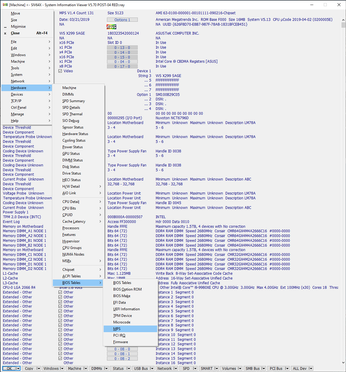

I am afraid I am not able to see
Where is “menu” field??
And [Machine] field seems to me that is identical with one or two cpu installed.

Reply 26 of 64, by red-ray
Mamba wrote on 2023-04-02, 19:22:
A picture is worth a 1000 words. I have also attached the SIV32X V5.70 POST-04 test SIV that with a bit of luck should report the CPU status on [Machine], does it please?
I was hoping to test it with the .DMI file, so fingers crossed I got the code right.

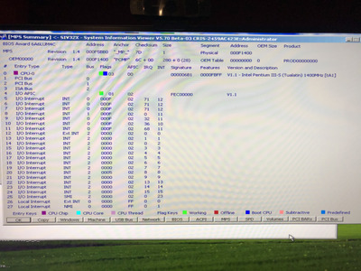

Reply 27 of 64, by Mamba
red-ray wrote on 2023-04-02, 20:03:
This is what I see
Reply 28 of 64, by red-ray
Mamba wrote on 2023-04-02, 20:26:
This is what I see
Oh! It's disabled in the BIOS, are you sure there is no BIOS setup option to do this?
I assume you have tried re-flashing the BIOS, I suspect several times, have you?
To take screen shots either press PrtSc or Alt+PrtSc then paste it into such as mspaint and save as .PNG.
I was expecting [MPS] to show both CPUs with one being off-line, maybe this only happens when the error is CPU Disabled By BIOS (POST Error).

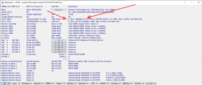

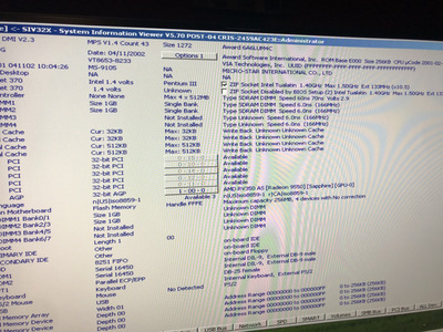

Reply 31 of 64, by red-ray
I just noticed this and it makes no sense at all. When one CPU is removed the bit-6 in the status byte should change, it did on my TYAN S2466 Tiger MPX and AFAIK does on the 19 other multi-socket systems own.
Would it be sensible for you to post the two [Machine] screen shots so I can see if I can spot a difference?
Reply 32 of 64, by Horun
Mamba wrote on 2023-04-02, 21:12:
The issue was exactly the same with the old 1.1 bios, after update it stayed.
red_ray you may be on to something since the readout is same and should be different (am no expert on your tool but it totally makes sense).

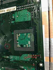

Reply 34 of 64, by Mamba
Nexxen wrote on 2023-04-02, 21:16:
There is no option in the bios to enable or disable one cpu. I am sure someone with the same board here can confirm. Actually I […]
red-ray wrote on 2023-04-02, 21:00:
Oh! It's disabled in the BIOS, are you sure there is no BIOS setup option to do this? […]
To take screen shots either press PrtSc or Alt+PrtSc then past it into such as mspaint and save as .PNG.
Actually I am surprised no one showed up already…
Do not know what to say.

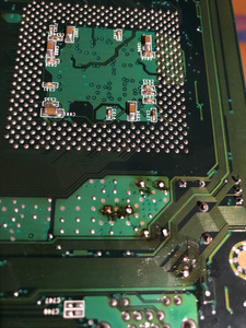

Have you fanatically checked all traces to be sure nothing is cut, broken or damaged?
Here the back of the cpu2 zone, where three caps have been replaced. Before and after cleaning with isopropyl alcohol.

Reply 38 of 64, by shevalier
Mamba wrote on 2023-04-03, 04:43:
Check red area
