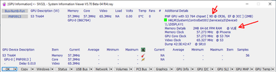

Actually I get 17MB/s on VLB and 18MB/s on PCI bus. It's definitely not an ISA bus 😉

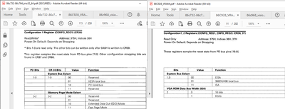

With hindsight I should have RTFM, I now have and from SIV 5.70 Beta-04 the bus type will be reported 😀

    Read the forgotten manual

Consider replacing "VLB" with just "Local Bus" - it's impossible to tell apart VESA vs. Opti vs. onboard in software.
I don't understand what this means, Local Bus could mean either of VESA Local Bus or PCI Local Bus , SIV is reporting the GPU not the motherboard chipset.
The GPU chipset datasheet specifies VESA Local Bus for the mode the GPU is using so it's sensible for software to report this for the GPU.

Yes, one datasheet refers to that as "VESA local bus", but the other as "386DX/486 local bus".
The latter is more precise, because it doesn't imply that the VESA slot is used.
386/486 local bus can be used via VESA slot, Opti slot, maybe some other slot, or onboard = no slot at all.

Earlier posts make it clear the 86C764 is on the motherboard and not in a VESA slot at all, so why are you now talking about VESA slots?
For a 86C764 GPU to be operating in VESA Local Bus mode clearly it does not need to be in a VESA slot.
Further the SIV screen shot shows it's a 86C764 and the 86C764 datasheet says VESA Local Bus so what SIV is reporting is 100% correct.
Basically what you keep posting makes no sense at all.

I am quoting what is in the S3 datasheet and clearly you need to tell S3 to correct their 86C764 datasheet.
Please don't shoot the messenger!
Further I feel you are incorrect and need to get your facts right before you post

Yes, it's the MODE the GPU is operating in. It can be in PCI mode or VLB mode and as to what is connected to does not matter.
Yet again on the [GPU Information] panel SIV is reporting the GPU mode and nothing more. It is not saying anything about the motherboard chipset.
Were SIV to report what you are talking about it would be on the Menu->Hardware->Chipset->Chipset MCH panel as it's nothing to do with the GPU mode.

Nevertheless, S3 isn't consistent in using that term.
Yes, I posted sections from two datasheets partly to show this and also to show the 86C924 had ISA + ESIA modes.
We will have to live with inconsistent names in 20+ year old data sheets, I am far more interested in getting S3 86Cnnn datasheets that are not scans so I could search them than worrying about this.

[For a 86C764 GPU to be operating in VESA Local Bus mode clearly it does not need to be in a VESA slot.
That is correct, VLB is basically direct to 486 with fluff and frills, just wiring it to CPU directly with a local bus that does not have the Vesa fluff and frills, will still look like VLB, there's not a way to say "Hey look they didn't install a socket with all the power and the pins in the right places"
no
red-ray wrote on 2023-04-02, 15:23:
there is no such thing as VLB mode. VLB describes just dropping piece of electronics on raw CPU memory/data bus. Same Trio32/64 chips were used in Amiga graphic cards https://bigbookofamigahardware.com/bboah/product.aspx?id=463 in exact same way, chip connected to Zorro memory/data bus. I dont have to mention Amiga never had VLB 😜 Even chip manufacturers can make mistakes in their own documentation, or fill it with marketing jargon.

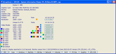

Thank you for checking and 1600 x 1200 x 16-bit colour would make me a very happy bunny 😀
I was looking at was was possible on my 4MB PCI 86C968-P (Diamond Stealth64) earlier today which offers almost the same, but noted such as 1280 x 1024 x 16-bit @ 60 Hz did not display well on my Dell 2007FP, but @ 75 Hz did so it would be good to know what rates are supported. I am biased, but feel SIV displays this information well.
