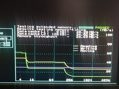

Reply 8 of 50, by Rav
Disruptor wrote on 2023-04-03, 06:15:
Ah, it's a DX4 backport then. Then I do not wonder why it runs with 50 MHz FSB at all. Perhaps it was binned down to DX2-66 beca […]
Rav wrote on 2023-04-03, 06:12:
The complete model I have is the TI486DX2-G66-GA. It is 3.45v so maybe there is hope, going to do more research tomorrow...
Perhaps it was binned down to DX2-66 because some tests at 100 MHz have failed (1st candidate is L1 cache ofc.).
Perhaps you have success with 3.6 Volt or 4.0 Volt.
And, yes, you may try first whether you get your L2 cache working in write back mode at 66 MHz.
Cyrix 486 had write back L1 even in their DX, while Intel has introduced it in the later DX4 first.
So you may need to try both jumper settings.
Tools:
the cache graphs in SpeedSys 4.78
ctcm 1.7a from c't (heise): ctcm7 /nop
I did notice that I get WT for L1 if the bus is 33, and WB if the bus is 40 or 50.
For the L2, it's WB for 33 and 40, then it's non existent for 50
Changing the CPU voltage won't change a thing for the L2 I think. It was already at 3.8 (oups). I set it back down to 3.45.

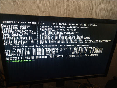

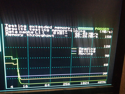

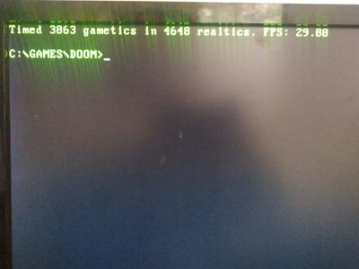

66Mhz(33fsb):
397 KiB
1384 views
405.85 KiB
1384 views
302.06 KiB
1384 views
More will follow in a few minutes

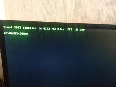

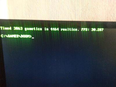

Reply 9 of 50, by Rav

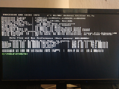

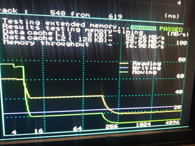

80Mhz(40fsb)
427.82 KiB
1383 views
438.74 KiB
1383 views
315.8 KiB
1383 views
Reply 10 of 50, by Rav

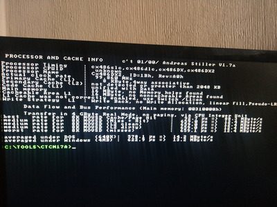

100Mhz(50fsb)
429.61 KiB
1383 views
405.67 KiB
1383 views
320.71 KiB
1383 views
Reply 11 of 50, by Rav
40 Mhz seam to give no real advantage over 33 (because of the memory drop)
50 Mhz, Maybe I should just use that and forget about the cache... Until I can get a DX4+
Will take the board out tonight and see if I can measure something between B14 and VCC while the CPU is on the board, and if so, Will connect B14 to VSS and see if that change something.
