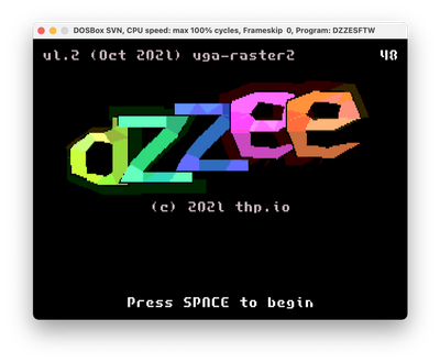

Here's the final build. As the behavior of real hardware vs Glide Wrappers (PCem/DOSBox-X/nGlide) was different, I actually got myself a Voodoo Graphics board this week to test it myself, and it works at 60 FPS on my K6-II 500 MHz.
Download below.
Screenshots:
186.35 KiB
2100 views

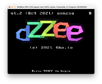

OSMesa (OpenGL) VGA title screen, with dithering
160.34 KiB
2100 views
Custom rasterizer VGA title screen
140.72 KiB
2100 views

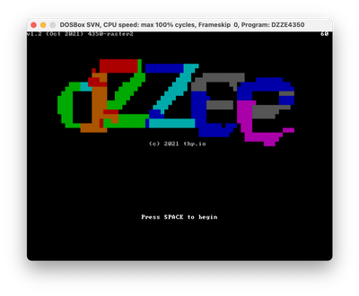

Text mode (80x43) EGA/VGA title screen
152.41 KiB
2100 views

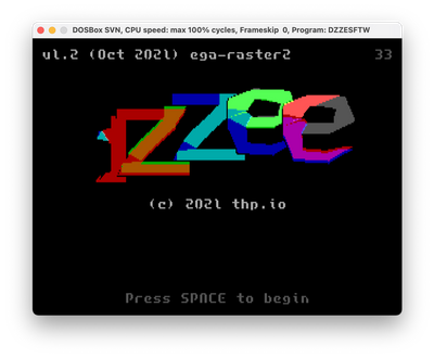

Custom rasterizer EGA title screen
Some pitfalls / learnings from the Glide porting:
  • One can poll grBufferNumPending() and avoid overfilling the FIFO (wait until there are no pending buffers)
  • Vertices are snapped to a 0.0625f pixel grid, the CPU rounding could be slightly different than what the graphics chip does and can cause hangs/delays (I do it the naive way and multiply it by 16, convert to long, then convert back to float and divide by 16, which the Glide Manual says exactly not to do because of performance reasons, but hey, works well enough in my tests)
  • OpenWatcom needs the NOCASEEXACT linker option to link against glide2x.lib from the Glide DOS SDK
This new build adds a 16-color EGA version of the software rasteriser (EGA vs VGA is detected automatically, use "ega" (lowercase, without the quotes) to force the 16-color mode on VGA boards. Also, a super weird EGA/VGA text mode version for really old computers (16 colors, 80x43 "resolution"). And zyzzle gets 128 lives by just passing their username as first command line parameter.
That's it: The Glide version works, and the VGA software rasterizer turned out pretty nice, and I learned a lot about Glide, OpenWatcom, DOS overlays, OpenGL on Windows 95 and new Win32 API features. Also about EGA's planar mode, detecting CGA vs EGA vs VGA and implementing a crappy 16-color text mode rasterizer. Also, 8-bit Sound Blaster audio output under DOS. A small multi-weekend project coming to a close 😀

- 16-color EGA mode support for DZZESFTW.EXE (force using "ega" option)
- New "mode 4350" build (DZZE4350.EXE) without sound, using text mode
