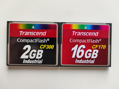

I'm currently in the process of replacing my standard CF cards with industrial grade ones.
83.84 KiB
1182 views
I didn't really have any issues with the standard cards, but I recently got a good deal for their industrial counterparts, so I figured why not. As before, the smaller 2 GB card will be used for MS-DOS 6.22, while the larger 16 GB one will host Windows 95 OSR 2.1.

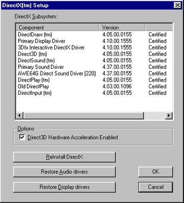

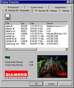

Made a few changes on the software side while reinstalling Win95. Previously, I was using DirectX 7.0a and the latest official Voodoo drivers v3.01.00. However, I noticed a few minor issues with that. First, the game Pandemonium! wouldn't recognize my Voodoo card during the installation process, so I had to manually copy over the relevant executable. Not a big deal, but still somewhat irksome. Second, the retail version of Unreal (without any patches applied) would crash on startup.
For that reason, I decided to try DirectX 5 and older Voodoo drivers this time around. I first installed the Voodoo drivers from this Diamond Monster 3D installation disc. After that, I applied the Glide 2.43 runtime update and then installed DirectX 5. Both of these are available on the Unreal CD, but I ultimately went for the slightly newer DirectX 5.2 which is archived here. I didn't install the full SDK, just the redistributable itself. And finally, here's the end result:
54.74 KiB
521 views
41.5 KiB
521 views
And what do you know, Pandemonium! now correctly detects the Voodoo card during installation, and unpatched Unreal works fine as well. Since I'm mostly playing early Win9x games on this system, I think I'll leave it like that.

Joseph_Joestar wrote on 2024-01-08, 17:23:
Made a few changes on the software side while reinstalling Win95. Previously, I was using DirectX 7.0a and the latest official Voodoo drivers v3.01.00. However, I noticed a few minor issues with that. (...)
but I ultimately went for the slightly newer DirectX 5.2 (...)
Sensible choice. The first Vooodoo does not have built-in hardware-support for DX features beyond DX 3.0, and even the Voodoo 2 does not support features higher than 5.0.
